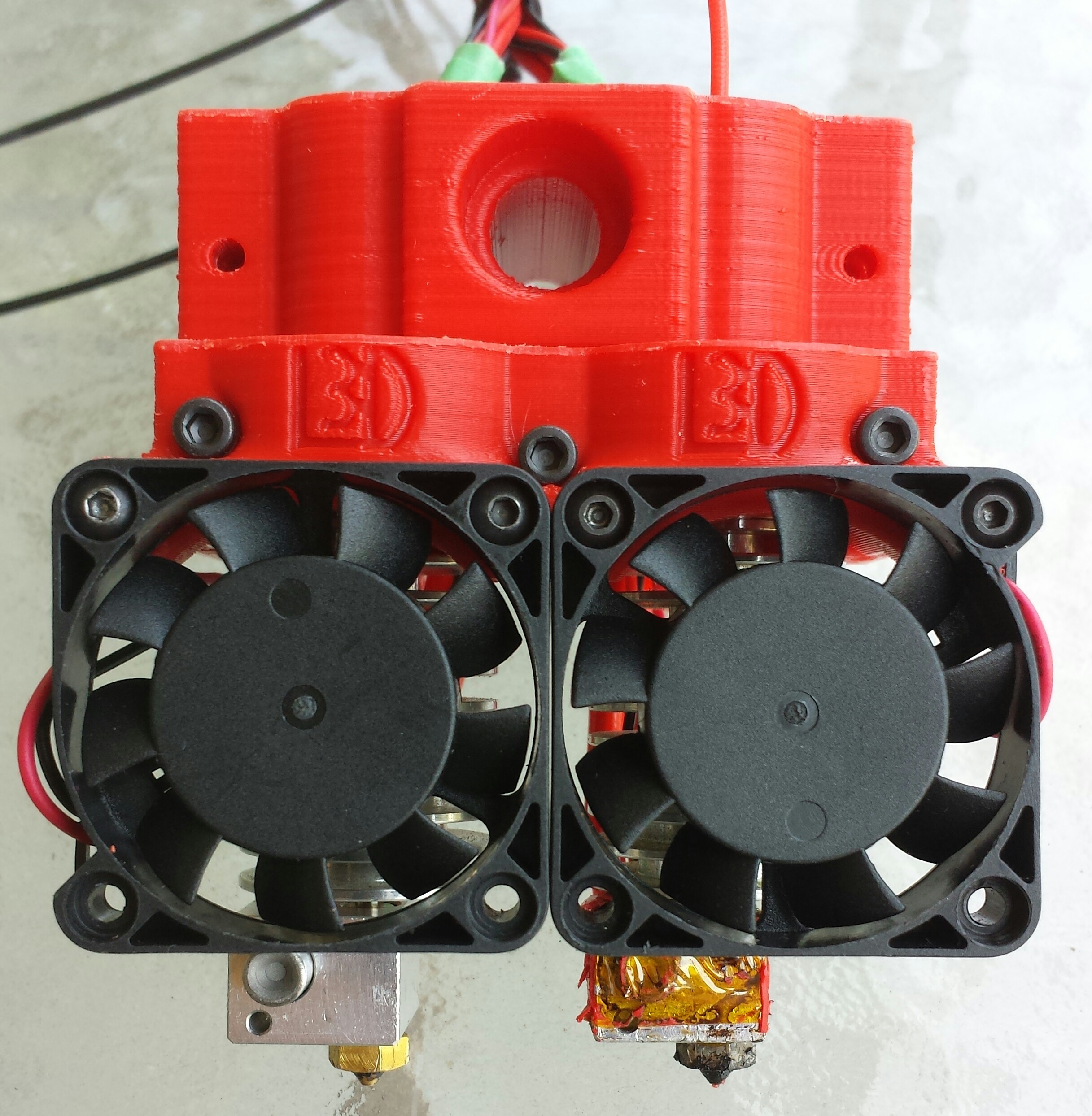

A little further progress on the carriage design. Front clamp/fan-mount works great. I will be adding some directional ducts that mate the outlet of the fan to the heat sink later. Also I still need to design the part fan ducts. But it’s getting closer.

Both heatsink of hotends are covered with motors of fans. The air flow goes not to heatsinks. A single fan in the middle would be more effective.

@Maxim_Melcher it will when its ducted. Ducts will bolt to the lower fan holes. Also fans like this move the majority of the air near the tips. So it would actually work just fine how it is.
