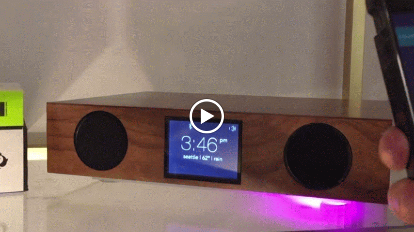

A little help from the top-notch FastLED library and an array of 56 WS2812B
A little help from the top-notch FastLED library and an array of 56 WS2812B LEDs actually made it fun (and fast) to code the “glow” features of Glowdeck I demo in the video.
Interested in helping me develop the music sync feature (previewed briefly in the video)? Add a comment with how I can contact you.
And many thanks to the FastLED community!
I should also mention that the Glowdeck PCB is based on the same microcontrolle used on the Teensy 3.1, is fully Arduino compatible, and most importantly:
Features a pair of analog converters to feed the incoming Bluetooth streaming audio into two analog pins on the MCU. So where audio-reactive code using an FFT and an electret microphone need to compensate for ambient noise, the Glowdeck board gets a clean line-level audio signal from both left and right channels.
