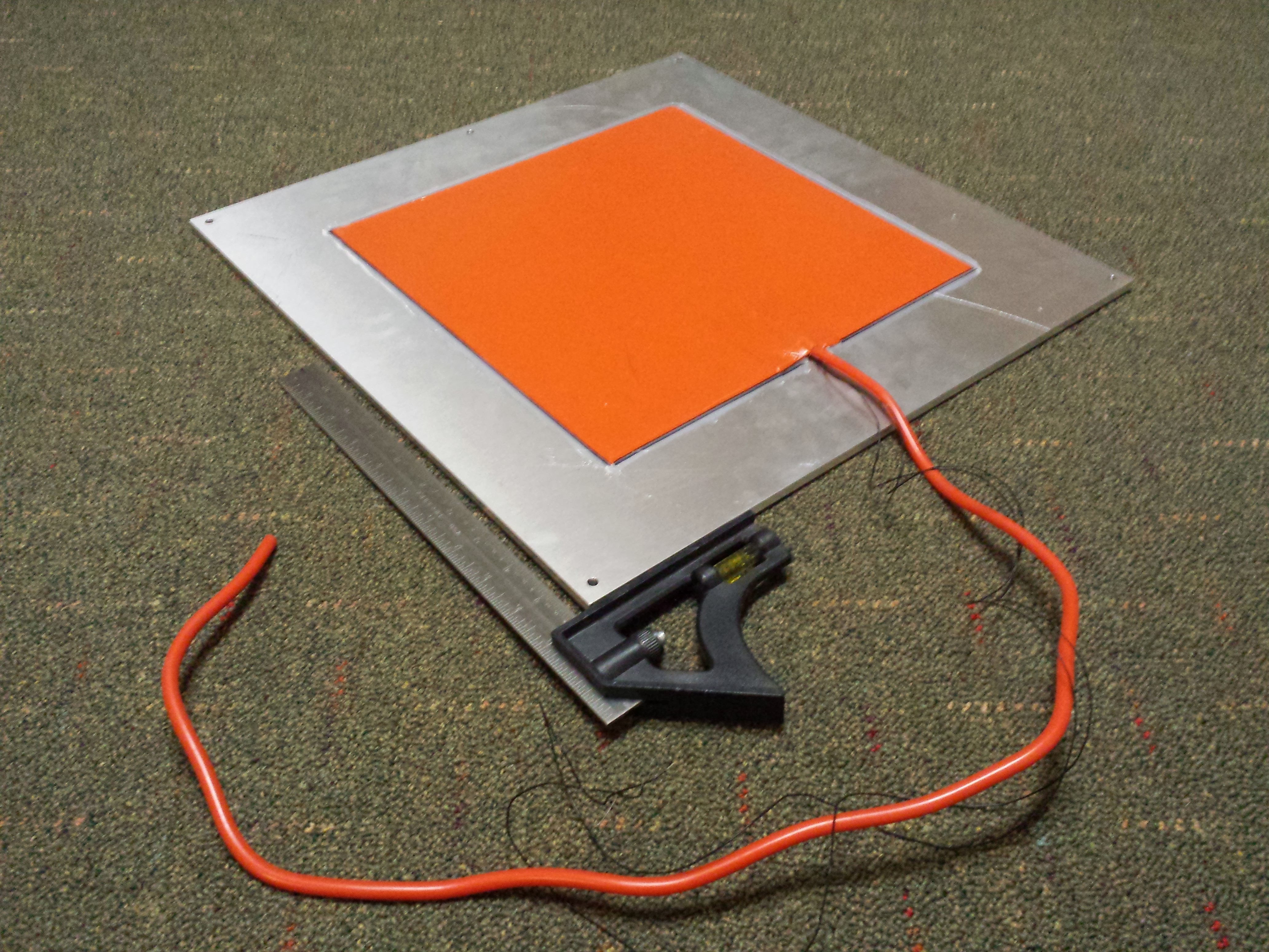

A little more progress on my printer design:
3 point bed leveler/heated-bed/heat-spreader (done)
Final aluminum x/y support plate to replace prototype wood version (done)
Still finalizing my extruder carriage to include the x-endstop. But I am so close to my first print I can almost taste it.
Very nice work. What did you use to glue the silicone mat to the aluminium plate with?

@Eclsnowman Love the three point bed leveling that is actually what I am doing on mine. Love what you’ve done and look forward to future updates

@Wayne_Friedt high temp silicone adhesive.
Amazing. Where have you bought that small silicone mat? It looks far thinner than the ones I’ve seen.

@Samuel_Ureta it only looks small because the build platform is so large. It is actually a 12"x12" 24v heated mat from: http://store.qu-bd.com/product.php?id_product=60
May i ask what kind of control board are you using?

@zhi_rui_Tam azteeg x3. I read several posts saying the x3 is good for high power 24v applications.
