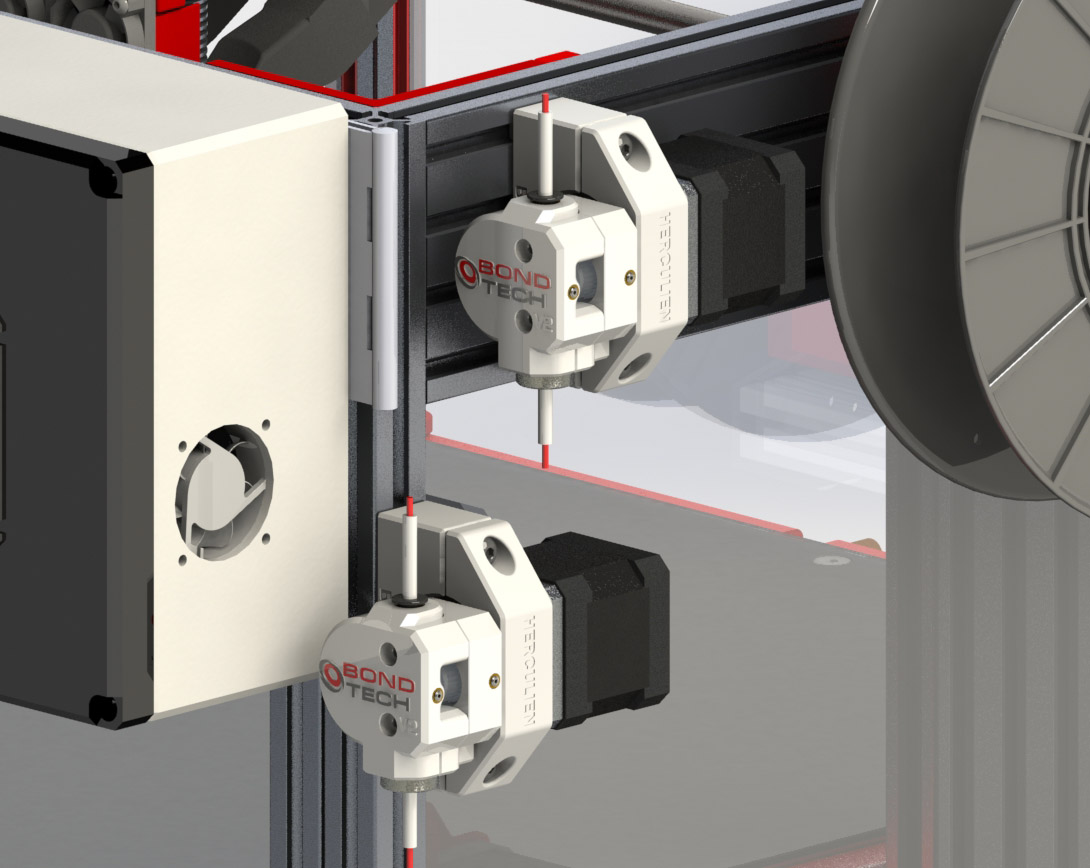

A mount to fit the Bondtech Extruder to the Herculien-frame, c-c distance is 60 mm to fit on the top 20x80 extrusion. Use 35 mm long M5 bolts and M5 T-slot nuts.
STL-file downloadable from http://www.bondtech.se/stl
That is awesome thank you!
You are welcome @Vic_Catalasan
I know what I’m printing tonight. Great job as always Martin.
really like the design @Martin_Bondeus , sexy. I’m going to print your housing in clear resin on my SLA printer…polish all surfaces to glass clear and smoothness so you can see all interior workings. I printed a glass clear version of @Walter_Hsiao 's housing on Thingiverse, it’s very cool to see the internal workings pushing filament onward.
