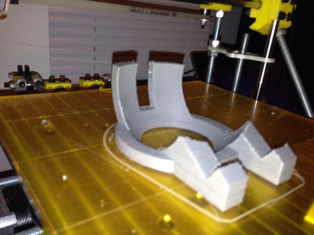

A Nexus 4 orb cradle I was asked to print.
A Nexus 4 orb cradle I was asked to print. ABS
I still have an Orca 0.2. I have some z issues that I think are coming from my left m8 threaded rod still being over constrained on the top and bottom. It is not bolted into the top bearing though, which I will remove when I put in the linear bearings for that side. It is still bolted into the bearing on the bottom though which will remain but I will be putting jam nuts above the bearing, rather than on either side, to remove any non-concentric movement of the rod.
That’s pretty smooth looking.
Hey nice print, That’s what im looking for, where can i get the scad or stl file?
http://www.thingiverse.com/thing:59441 or a different version
http://www.thingiverse.com/thing:89762
