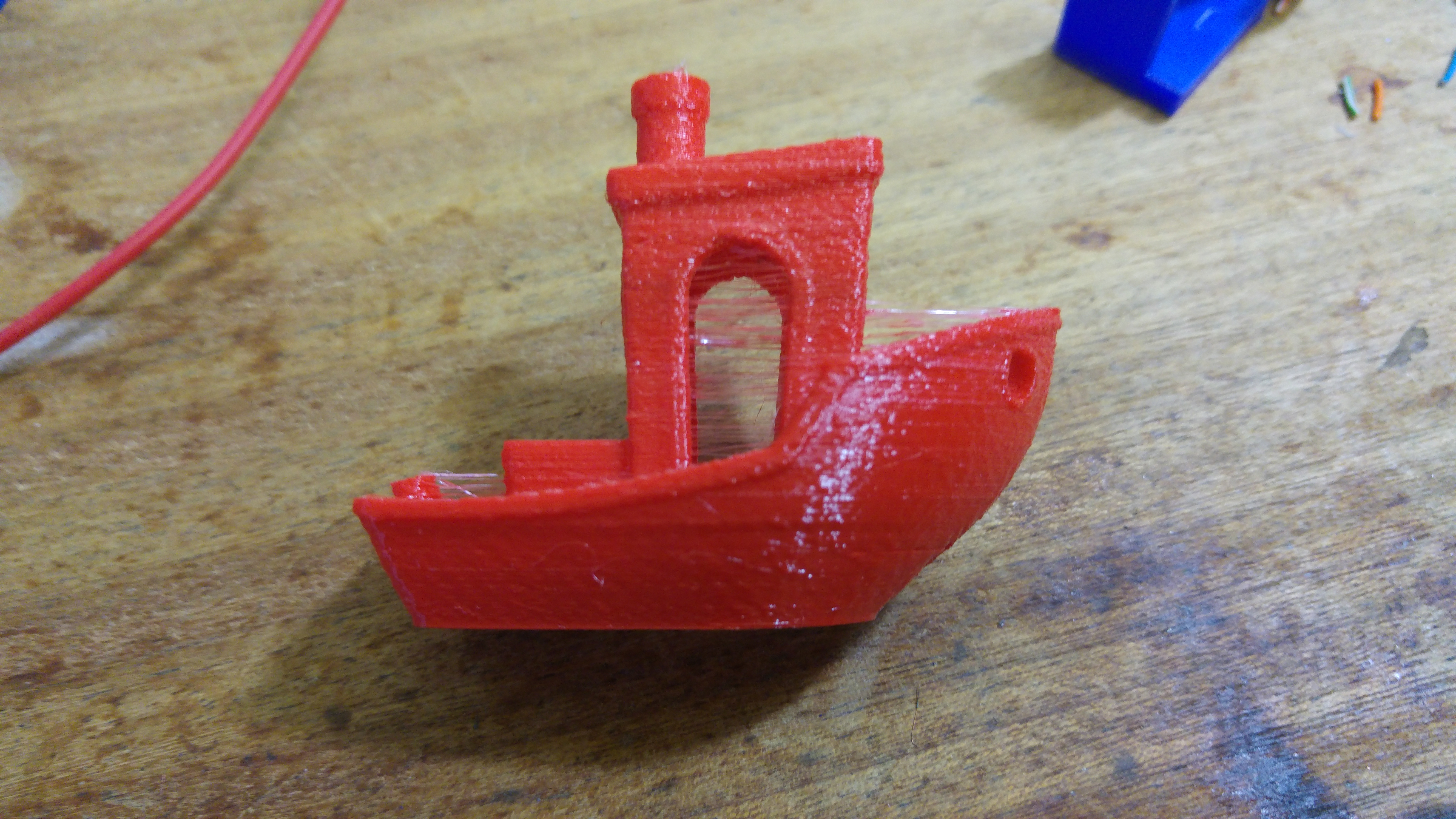

A printed in ColorFabb NGEN.
A #3DBenchy printed in ColorFabb NGEN. Printed on the CTCForge, which calibration is a bitch being powered by a Flashforge Mightyboard. Straight off the printer, retraction settings need to be raised a hell of a lot due to the stringing, but so far, I’m loving NGEN. The CTCForge is crap at bridging and drops strands all over the place, and likes to be hot, so this is the perfect Filament for it. I’ve not had a failure yet touch wood it just holds at 75/80°c on the bed with a coat of hairspray. It prints even easier than the XT and PLA/PHA. Safe to say, that this is now my go-to filament.
Yeah you need to have a lot more retraction. Other than that looks pretty good.
Yeah, it was set at 2mm, probably needs to go to about 3.5-4ish with NGEN

@Joseph_Chiu - aye know what to select, Only got one Extruder on the CTCForge as the other’s removed, so replicator single.
