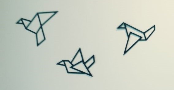

How do I create 3d model from this sketch, similar to the attached model
I do not need paper birds but 3d model (stl, obj). Model I can print in 3d printer
thats easy scan it and convert it in blender. you can import the scan as height map( greyscale for more heights or b&w for just the form raised) on a standard plaine or box, then just cut off the bottom part just make sure there are enough vertexes on the object thats being raised! then export as .obj btw blender 3d is free opensourse.

you can also use inkscape to vectorize and use https://www.thingiverse.com/thing:25036 to extrude this in open scad. Or use freecad to scetch and extrude

If you use Inkscape/OpenSCAD, you may not want to use the trace option within Inkscape, as it will take the raster image and toss in a few curves where you probably want straight lines.
As a test, I screen capped the small image and converted it to vector with Vector Magic. Not such a good result for the reason noted above.

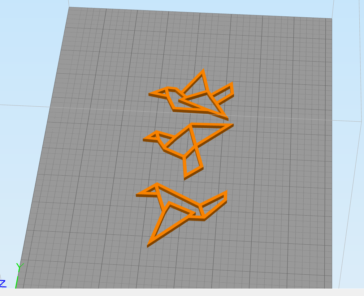

Importing the raster image and manually creating the lines in Inkscape produced much better looking birds.
If you go that route, consider the final size you desire and set the overall shape to that figure. Be sure to turn on the aspect ratio lock. Once you have the size, consider the wall thickness you desire and use Fill (none) and Stroke to set the stroke width to represent the wall thickness.
Use Path, Object to Path, then Stroke to Path to create a proper object for the OpenSCAD extension.
If you learn by experimenting, as I do, consider also to copy each satisfactory state of your work to a different layer. I did the stroke to path after setting the stroke width, but wanted to make it larger a few moments later and had no practical fall-back. Control-Z works well sometimes, but I had performed a few additional actions I didn’t want to undo to get back to the stroke-to-path option. For this particular exercise, it is easy enough to recreate the strokes for each bird, but I won’t make that mistake twice!
@Fred_U i would import that image in inkscape und use the fill tool (paintbucket) to generate the polygone
That was a fun project. 3 mm walls, 3 mm thick, 75 mm wide, height proportional. I probably won’t print them, but the exercise might stay in mind long enough for future projects of a similar form.
@Fred_U ​ You are a genius! We are all thinking models an stuff and here you go and literally give the poster exactly what they asked for. Hats off to you!
