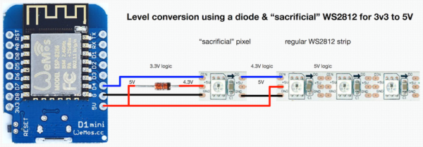

@Andrew_Tuline I think tht null pixel is very usefull. We can easy make it usefull (not only use as level booster). For example it may show some status.
More about null pixel here:
p.s. I think, that it would be nice, if FastLED library teached to setup null pixel. I mean, that NUM_LEDS would be as is now, but if we defined NULL_PIXEL_ON - library automatically will drive NUM_LEDS + 1 pixels. But this pixel don’t “touch” main pixels, [leds] array and calcs in main code procedures. Sorry for pore English.
