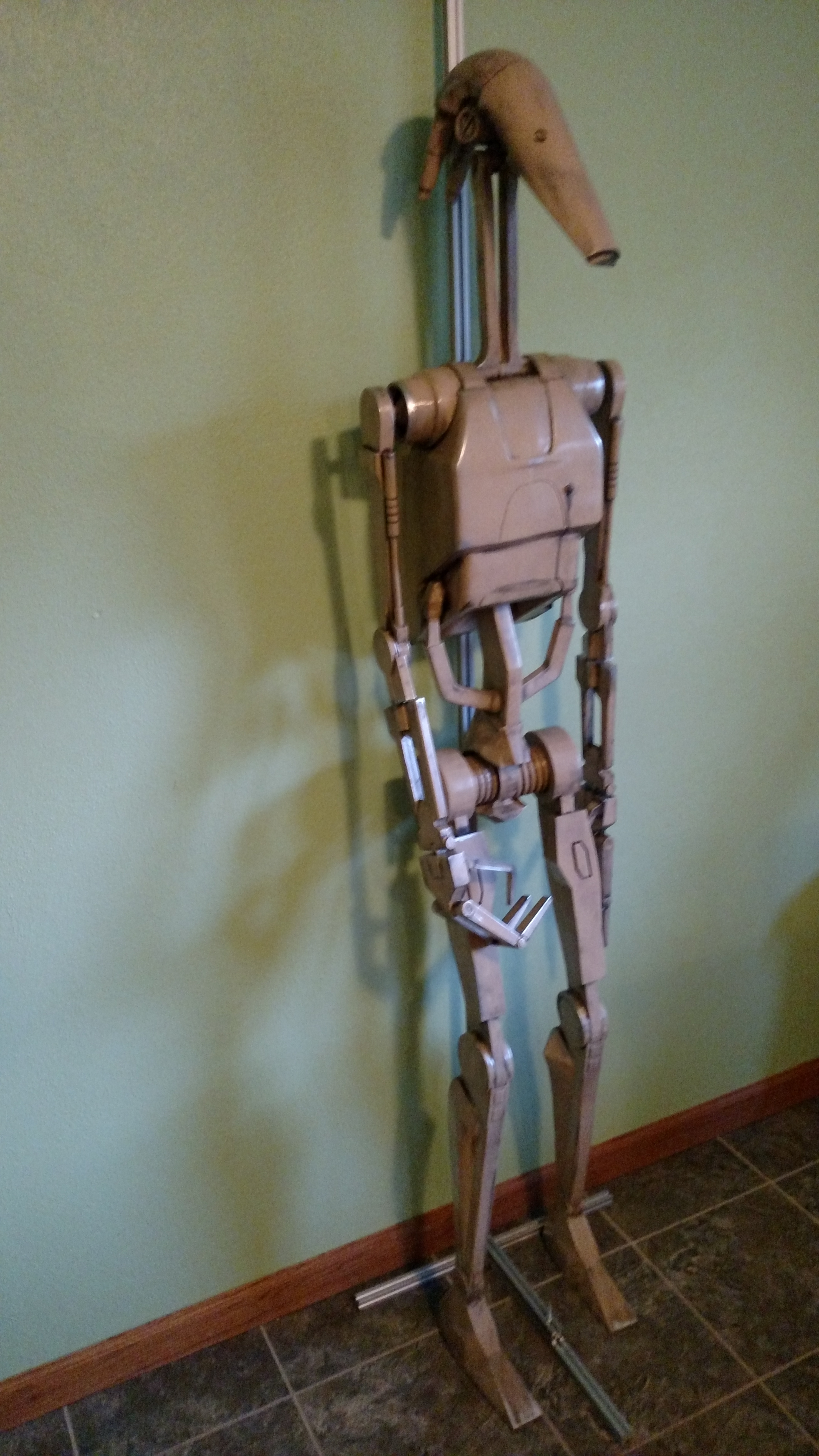

(The pic is for attention and relevance. I did the battle droid at .1 and .2mm layer heights. Some parts of things like this are fine for .1/.2 but plenty of bits would be nice to do thinner.)

@Andrew_Radovich_BadW : where did you get the STLs for the battle droid?

That look more like a Gungan than a battle droid…
