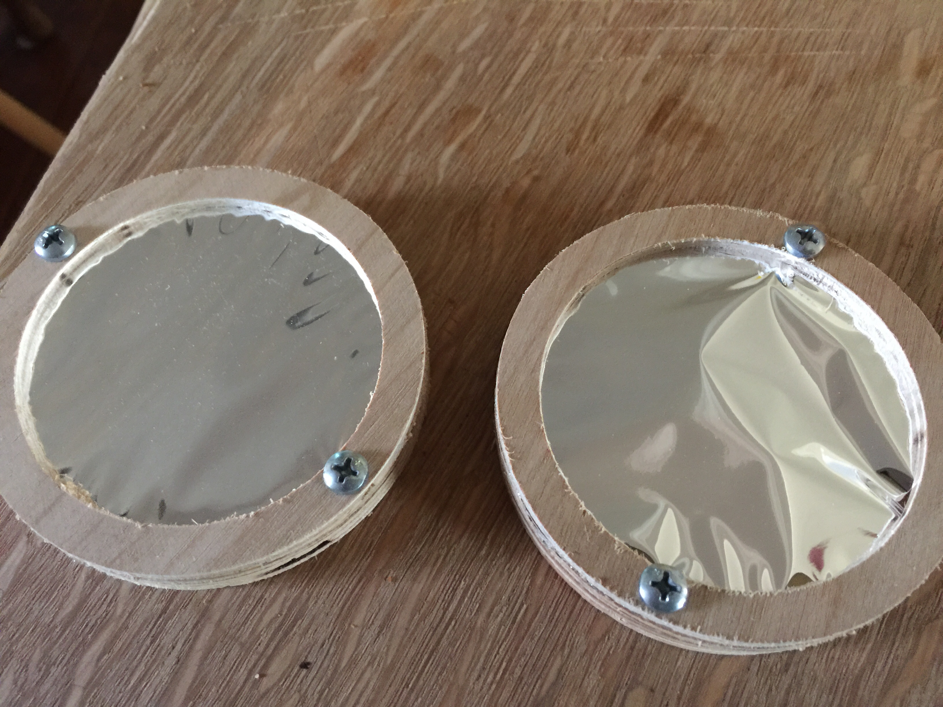

A quick last minute solar filter cell set for my binoculars and I am
A quick last minute solar filter cell set for my binoculars and I am off to the eclipse. The ID tapers .040 for a snug fit. The film is some scraps from a larger filter I made 12 years ago from Baader Planetarium.
