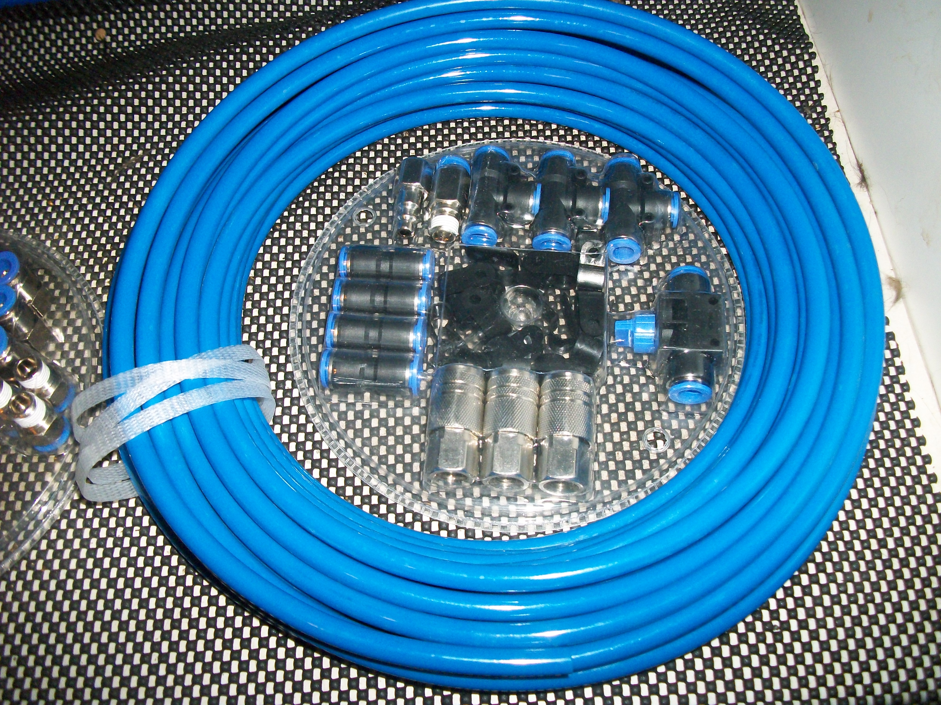

A quick mock up of the air assist system for my K40 and Redsail
A quick mock up of the air assist system for my K40 and Redsail LE400 lasers. It is controlled by a 12V solenoid (So I can turn it on/off with Gcode), and has an inline filter to reduce the risk of oils contaminating the material being cut or engraved, regulator, and pressure gauge. I am making the switch to running shop air from my big compressor, instead of an airbrush pump on each machine. I bought a 3 outlet airline kit from Lowes to get the shop air to the machines, as well as having an extra outlet available for air tools, etc.
