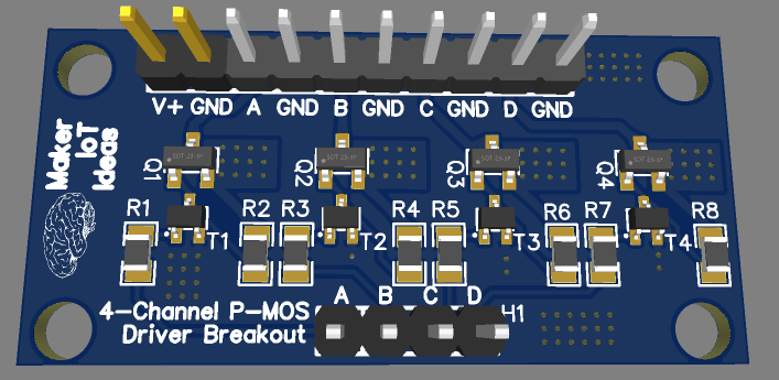

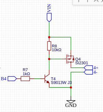

The Schematic
I decided to keep things extremely simple to start with, using a very simple circuit consisting of only 4 components per channel. These are :
– an S9013 NPN BJT Transistor, capable of switching up to 500mA of current
– a SI2301 P-Channel Logic Level MOSFET, capable of switching up to 2.3A
– 10k pullup-resitor
– 1k resistor on the base of the BJT
The theory of operation is as follows:
The pullup resistor, R8, keeps the gate of the MOSFET (Q4) positive, thus ensuring that Q4 stays turned off when T4 is turned off. A HIGH signal at B4 will turn on T4, which will in turn pull the gate of Q4 to ground, turning Q4 on in the process.
That will in turn turn on the load ( connected at 4+ and 4- ).
It is important to note here that the value of R8, 10K at the moment, is not finalised, and may change to increase the performance of the circuit.

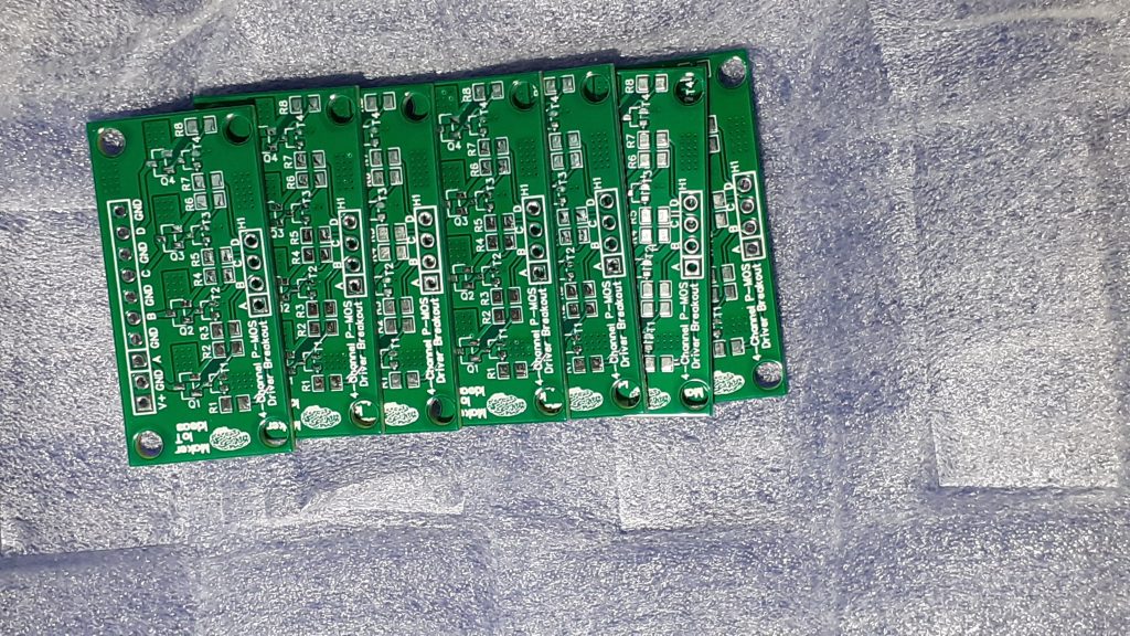

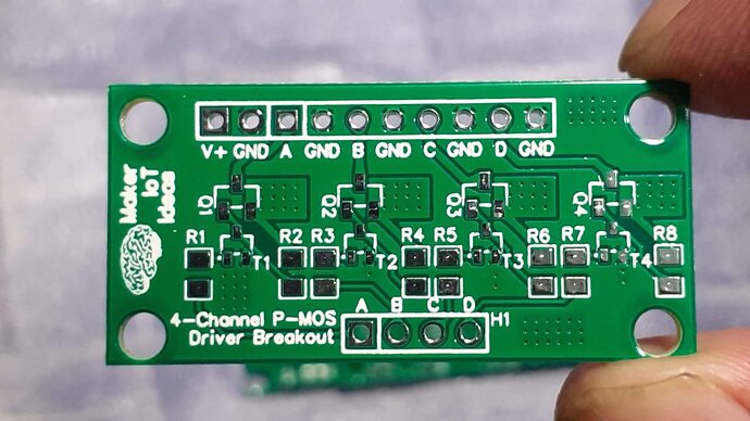

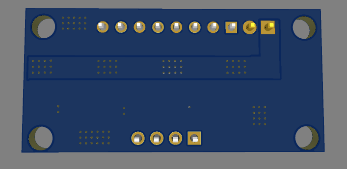

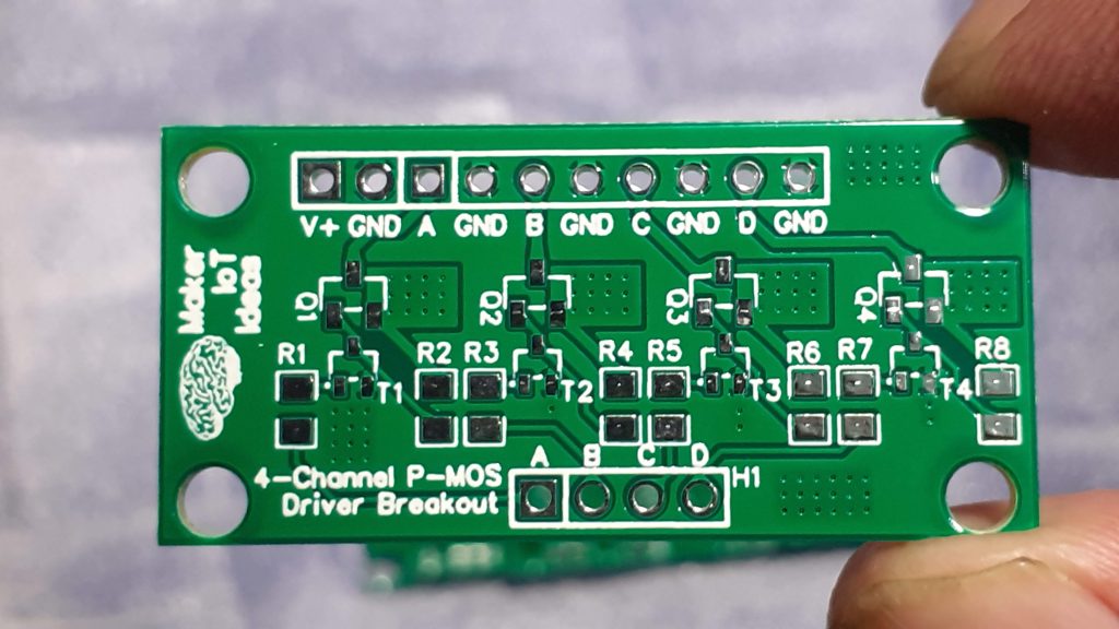

The PCB

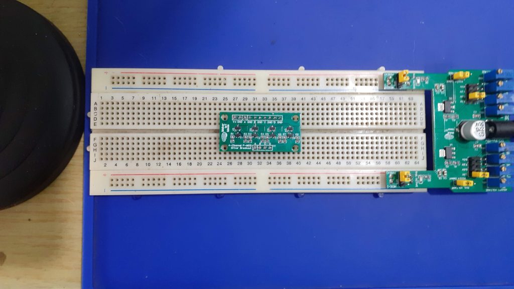

The board was made to fit on a standard breadboard or be used as a standalone module, depending on the position of the male header pins.
Manufacturing
The PCB for this project was sponsored by PCBWay.

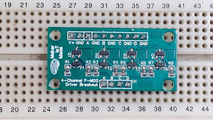

Assembly
The assembly of the PCB does not require any special tools, and can be done completely by hand if you choose. A very fine-tipped soldering iron should be perfect.
I chose to go the hot-air and solder-paste route, as it is faster, and looks neater in the end. The use of a stencil was not required.
The total assembly took about 5 minutes in total.

Testing the completed PCB module was performed with one of the LED light modules connected to each MOSFET Channel in turn, and then applying a voltage signal, or ground, to the control pin ( marked A to D on the picture above)
That was followed by connecting an Oscilloscope and Signal Generator to the control pins, as well as the outputs, and observing the waveforms during operation. A square wave output from the signal generator provided the switching signal.

I think the scope trace above corresponds to the schematic of this commercial driver. I modified this driver multiple times during testing as I did not need the high voltage capability.
Hmmm… From that scope trace, it looks very much like an overshoot issue… I have a similar “problem” on my 3018 “TOY” CNC machine, where the Laser burned out two control boards already… From what I can see ( on my own damaged boards ) there were no proper MOSFET Drivers installed on the board… MOSFETs are difficult little animals, especially the P-Channel sort… That gate current and parasitic gate capacitances are finicky… Drivers are also quite expensive…
I would be interested in taking a look at your driver board circuit, if you have it, to try and get to the bottom of this. It will ultimately also be to my own benefit too ha ha as I have been wanting to upgrade the 3018 to a more powerful spindle etc for a while now, but, due to the dubious performance of the controllers, I did not dare yet…
As to the circuit that you did send me ( the RIO Rand Motor Speed controller )…
That circuit basically forms a 12v Voltage regulator ( Q42 is controlled by Zener D25 in a pass-through configuration… I can not see any PWM generation part there so I am assuming that it is in a later part of the circuit…
Please get in touch, lets look at the schematics that you have and try to get to the bottom of this… I do believe it is do-able :slight_smile:
There are tabs at the bottom of the schematic page.
The driver is Q44.
There is a PWM tab that uses a 555 to generate PWM but instead, I used the output of the tinyG for PWM.

Hi @donkjr
As promised I had a look…
I found something on the schematic…
R64 and R68 form
a VOLTAGE Divider
I have made this mistake before. That configuration will in effect LOWER your gate voltage to 11.348v ( That is assuming that you actually get a full 12v input there, which with PWM can be as low as 3v at 25% duty cycle… (i.e 2.83v at the gate)
Change the position of R64 so that it connects between the top of R68 and the top of D15
Then, according to the datasheet of the MOSFET VGS is 10v, so it will not reliably switch at anything below that…
I suggest that maybe you implement a TOTEMPOLE Driver using two transistors, PNP and NPN on that MOSFET GATE , keeping VGS at below 20 v …
Maybe a voltage divider from the HV DC to get it in the 15 to 18v range, just to drive the gate??
What do you think of that?
