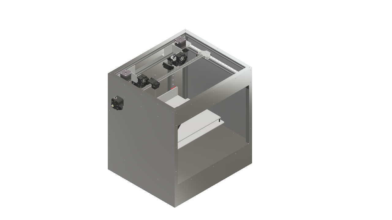

A quick render of a Printer I’m working on. CoreXY based tool changer. Build area of 300x200x200 running on rails and custom laser cut aluminium parts with very few printed parts. Will be running on Klipper firmware.

I would try to follow the example of e3d and use a belt path that avoids the top front cross member, it gets annoying not being able to reach straight in.
@Stephanie_A take a look in v2 of my repo for a direct drive
@Daryl_Bond I’ve not looked at E3D’s design that closely. Part of the design choice of this was to try and hide the belts, partially aesthetic, partially safety. Which has been partially achieved, but the rails in the way for the sides to do so.
