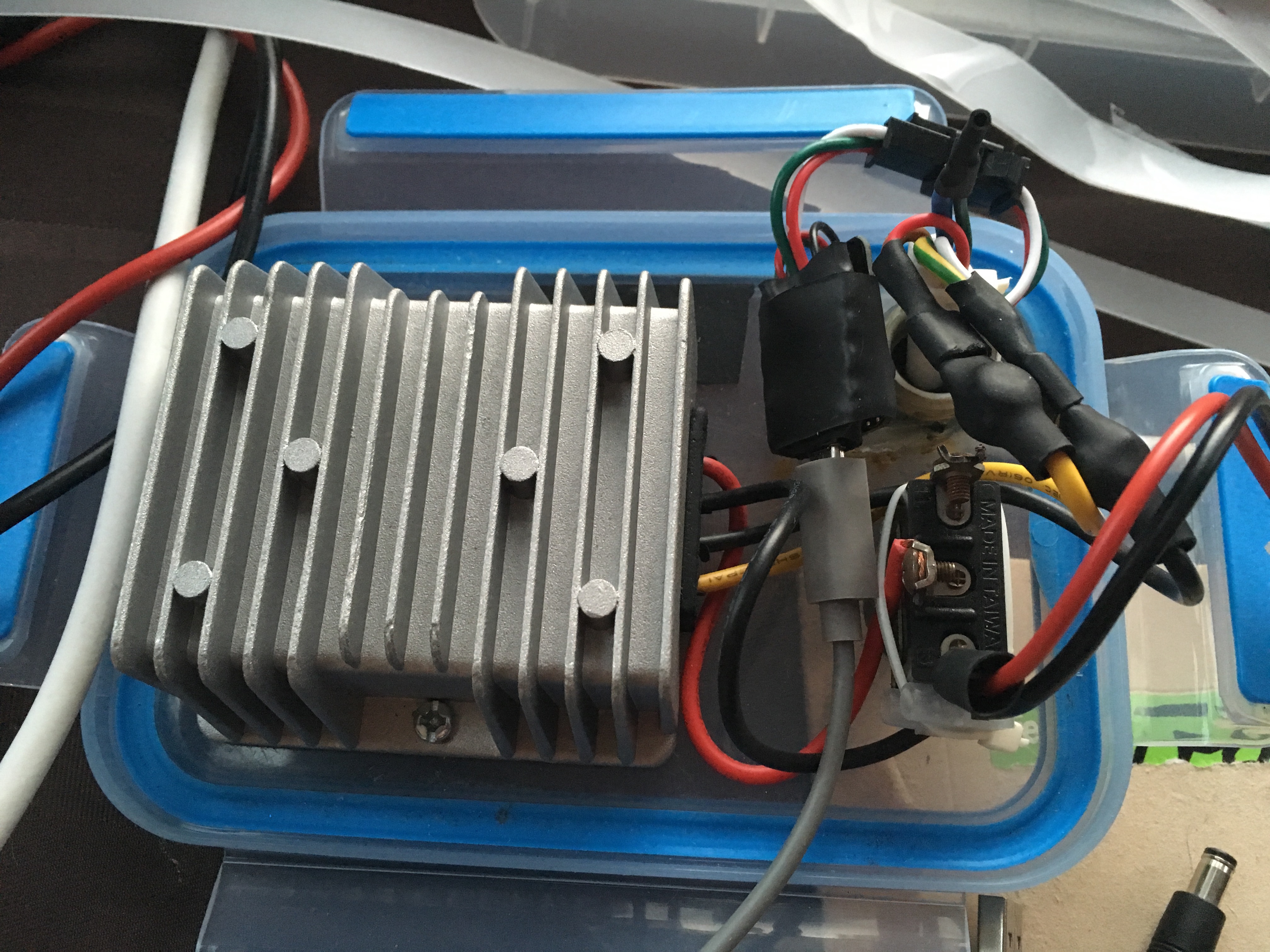

Construction is pretty simple, just stick the silicon-jacketed strips to RHS aluminium with tape and use copper braid at each end for a power bus (power is injected at both ends.) My first experiment with Sugru over the the top of that for weather-sealing and insulation (used the whole 15g I bought, and probably could have done with more.) Not sure if it was the best decision, or if I should have gone for some kind of liquid silicone I could dip the ends into or something. Protip: household power cabling is good for high-current low voltage over short distances, and is cheap and readily available (that thick wire is a bastard to solder though.) The battery/control box is some well-sealed tupperware to keep the dust out.
