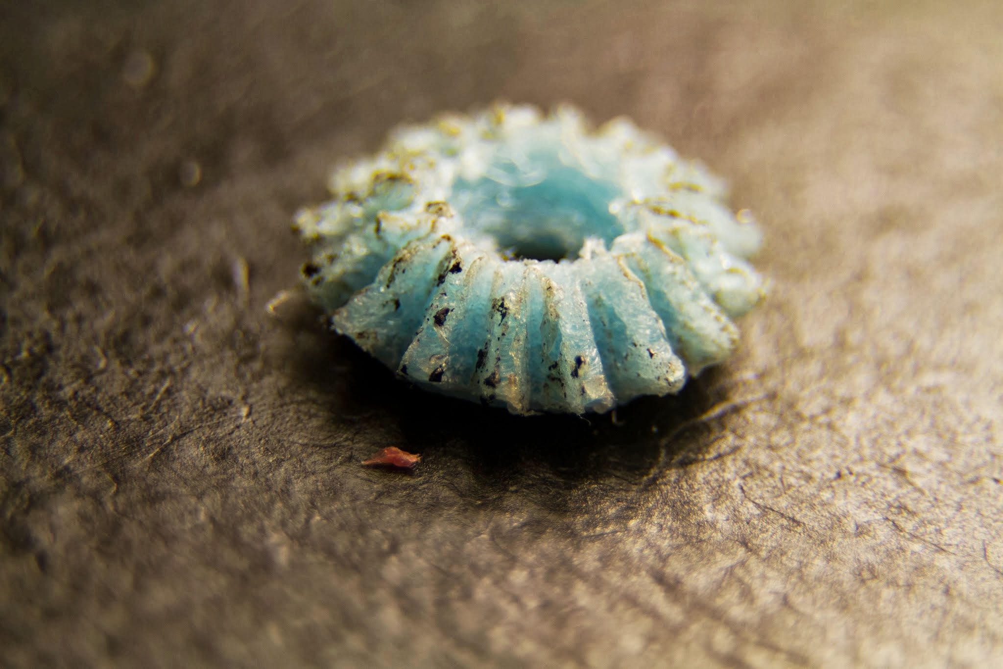

a quick tip on getting nice and smooth inner diff gears,
a quick tip on getting nice and smooth inner diff gears, if you have a soldering iron with a thin tip (a variable temp iron even better) do quick short strokes with the tip in each gear tooth for a very strong smooth finish,
i have a set of diff gears that almost turn like metal ones now…
the smoothest and what feels to be the strongest yet!!!
(BTW these are printed with line trimmer cord, i have found it to be just as strong as the taulmans 618 but with much less flex so it holds up for the diff gear much much better than anything else i have tried)
Great tip! My nylon diff gears look exactly as yours. (untreated) Don’t know how Daniel got his gears to look so good.

update: the gears seem MUCH stronger, they just lasted a run with the motor with no throttle limit and lots of hard turns (to the point i rolled a tyre off the rim and flipped the car lol) i’ll be doing this to all the inner gears from now on
