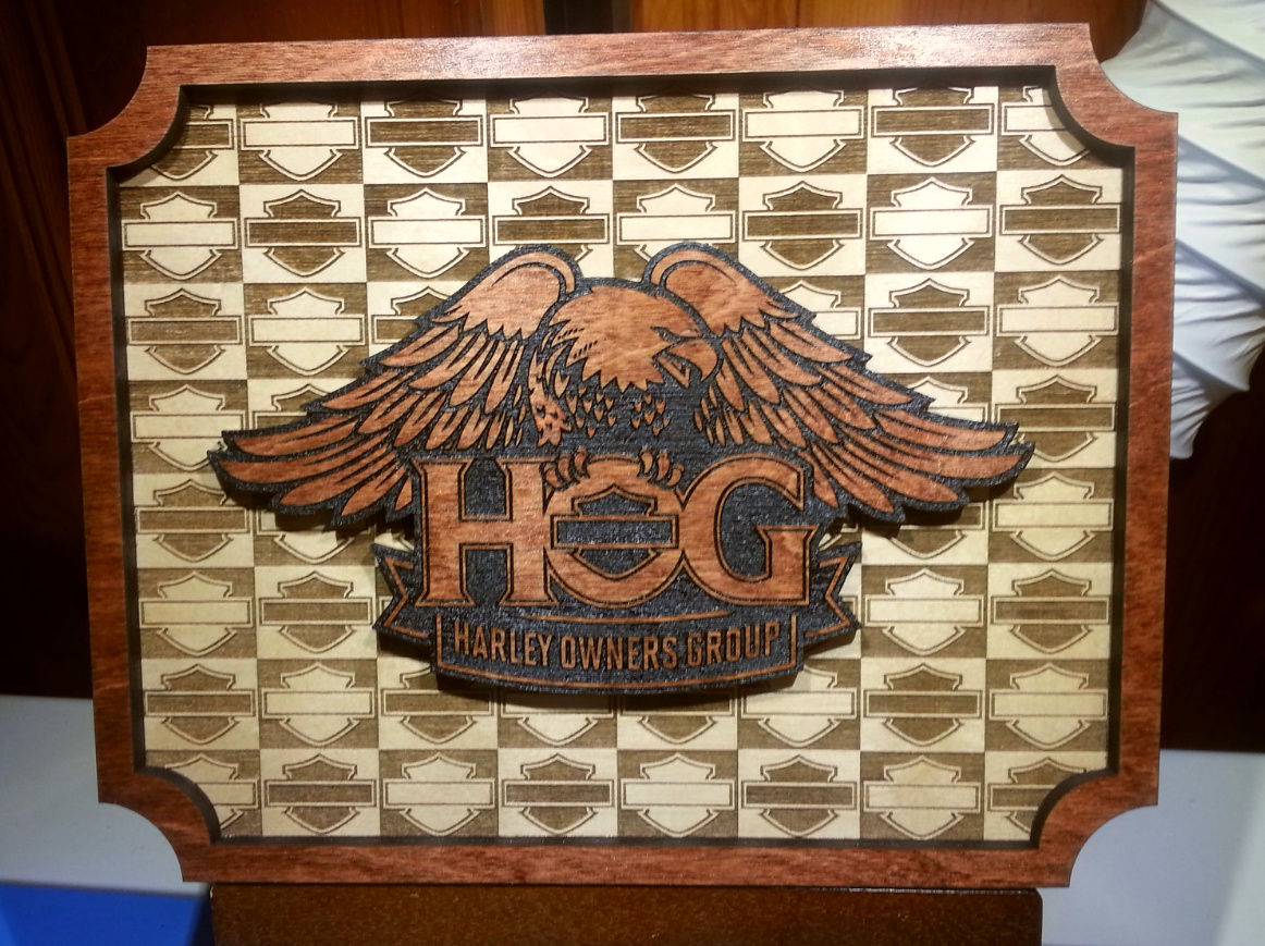

A remix of my last creation.
A remix of my last creation. Made for a friend of my mine that is big into Harley motorcycles.
Very Sweet!
These pieces look great. Keep up the good work inspiring us with your creations. Out of curiosity, what colour stain are you using for the main parts again? It’s a nice colour brown in my opinion.
Thanks @Yuusuf_Sallahuddin_Y . For stain I’m using Minwax Red Oak 215
That sir, looks wonderful! Well done :slight_smile:
That’s an amazing job! I would love to have that as I am a lifetime member of HOG. Was that all from a picture?
Thanks @Brien_Watson . It’s actually 2 layers. For the background I just lined up alternating bar & shield logos blocks and engraved/cut. The Frame and HOG logo were engraved and cut from the same piece of prestained wood. The wood was masked before engraving and I then painted the engraved areas of the logo with black paint to add contrast.
