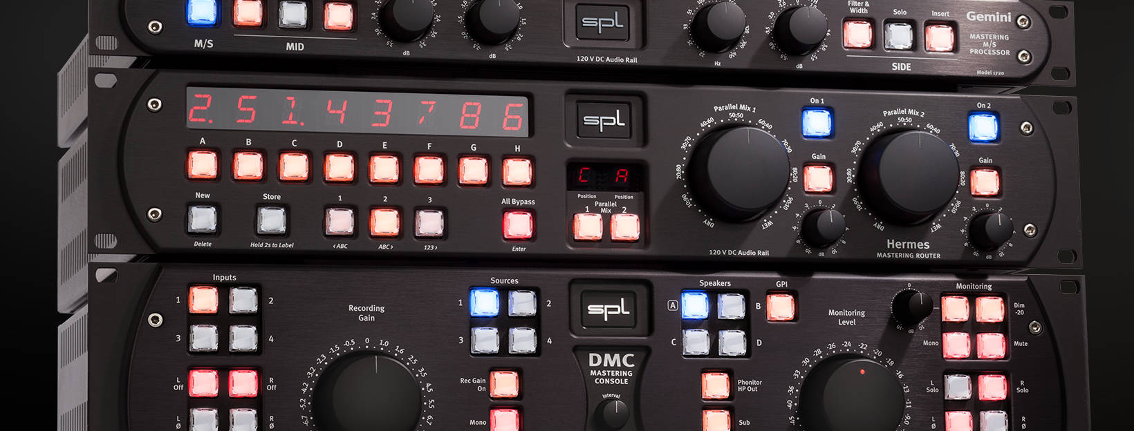

Here are a couple of articles discussing how a “transient designer” can recognize a transient regardless of its amplitude. Perhaps this could help with beat detection?
