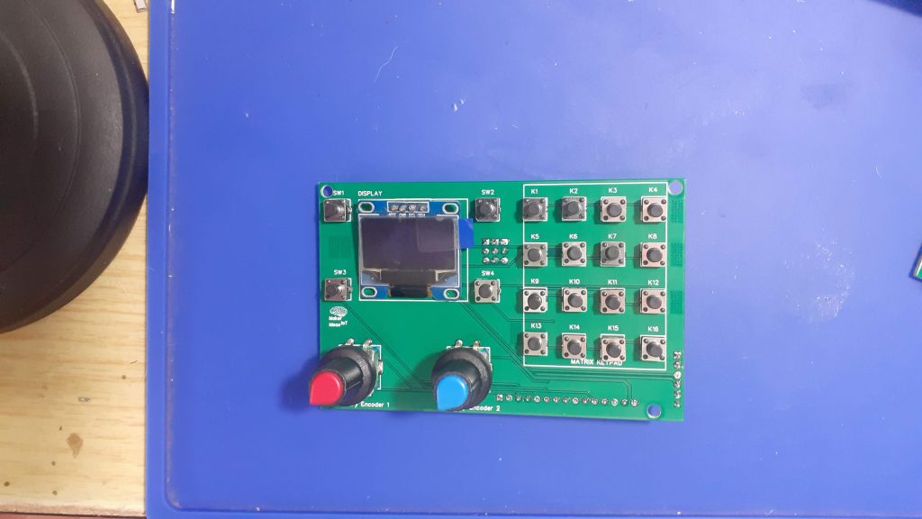

A simple IO Panel ( with keypad, buttons, encoders and a display ) that I made to make life easier during project design and testing
Multi-Purpose IO Card
When we are working on a prototype, we always need access to pushbuttons, encoders and even displays to test our ideas in the real world. This Multi-Purpose IO Card was designed to help me do just that…
What is on the PCB?

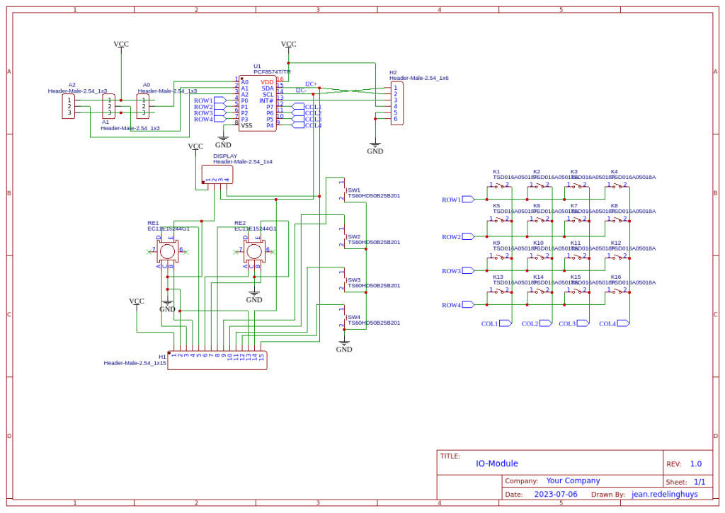

This PCB was designed with my particular work style in mind. I use a lot of I2C devices, IO Expanders, Displays and sensors. It would thus make sense to have I2C on the PCB, to control an OLED display, as well as a PCF8574 IO expander, that is used to drive a 4×4 Matrix Keypad. Two Rotary encoders, as well as another 4 standard push buttons completes the PCB…
The features, summarised is as follows:
1x Matrix Keypad (4×4) Controlled via an PCF8574 IO expander with selectable addressing.
1x SSD1306 OLED I2C Display
4x Momentary pushbuttons, configured to be used with internal pullups – i.e pushing the button pulls the GPIO LOW
2x Rotary Encoders, with integrated Pushbutton, also configured as Active LOW
The board has all of the connectors and jumpers on the back, making it possible to mount it to an enclosure as a control panel.
I have also provided an additional I2C header to make it possible to add additional devices to the I2C bus easily

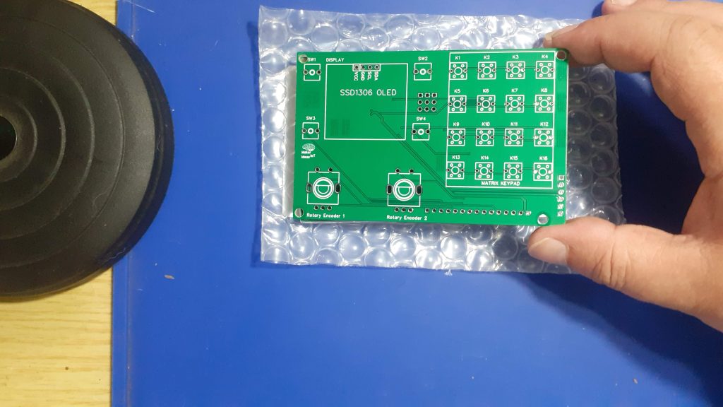

The PCB in Detail
PCB Top
Starting from left to right, we have two push-buttons, an OLED display, with two rotary encoders below the display, and another two momentary push buttons. On the Right, we have a 4×4 matrix keypad, and various pin headers for connection to a microcontroller of your choice.

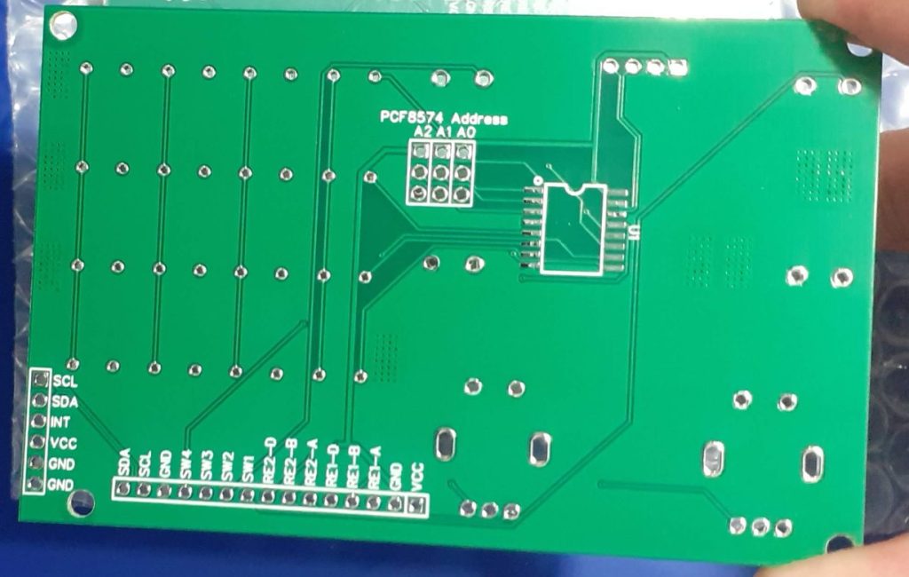

On the back, we have the PCF8574 IO expander for the Matric keypad, addressing Jumpers for the IO expander, as well as the two pin headers for connections to and from a microcontroller…
The Pinouts of these are as follows:
Horizontal 15 pin 2.54mm connector
SDA I2C Data
SCA I2C Clock
GND
SW4 Momentary Push Button 4
SW3 Momentary Push Button 3
SW2 Momentary Push Button 2
SW1 Momentary Push Button 1
RE2-D Rotary Encoder 2 Push Button
RE2-B Rotary Encoder 2 Pin B
RE2-A Rotary Encoder 2 Pin A
RE1-D Rotary Encoder 1 Push Button
RE1-B Rotary Encoder 1 Pin B
RE1-A Rotary Encoder 1 Pin A
GND
VCC 3.3v to 5v DC
The Expansion header extends the I2C Bus, as well as proved access to the interrupt pin on the PCF8574. VCC and GND are also provided.

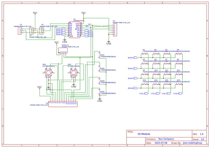

The Schematic

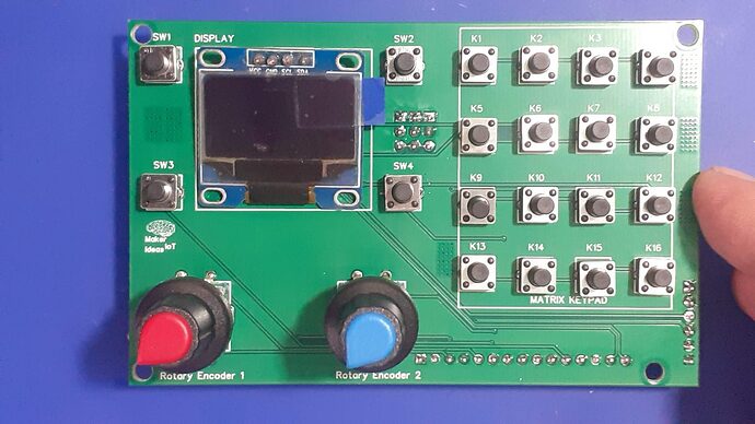

Assembly and Testing
The assembly of this PCB was relatively easy, as it contains only a single SMD component. I do however have to alert you to a certain caveat…
On the PCB, the I2C OLED display pinout is, from left to right,
VCC GND SDC SDA
I have however come across similar displays that swap the GND and VCC pins… and some that even have SCL and SDA swapped…
It is thus quite important that you check your display BEFORE soldering it to this PCB…
Addressing the PCF8574 is also quite easy, with the jumper towards the top is a high, and towards the bottom is a low… They are marked A2 A1 A0 and thus, counting in binary, all low will be 0x20h and all high will be ox27h
Also, note that there are NO I2C Pullup resistors on the board. My microcontroller PCB’s usually have these already, and most I2C Sensors, including the OLED Display that we use, already include as well…
You should thus check what you have on your own hardware, as it is quite impossible to cater for every situation… In a future version, I may add selectable pullup resistors onto this board as well…

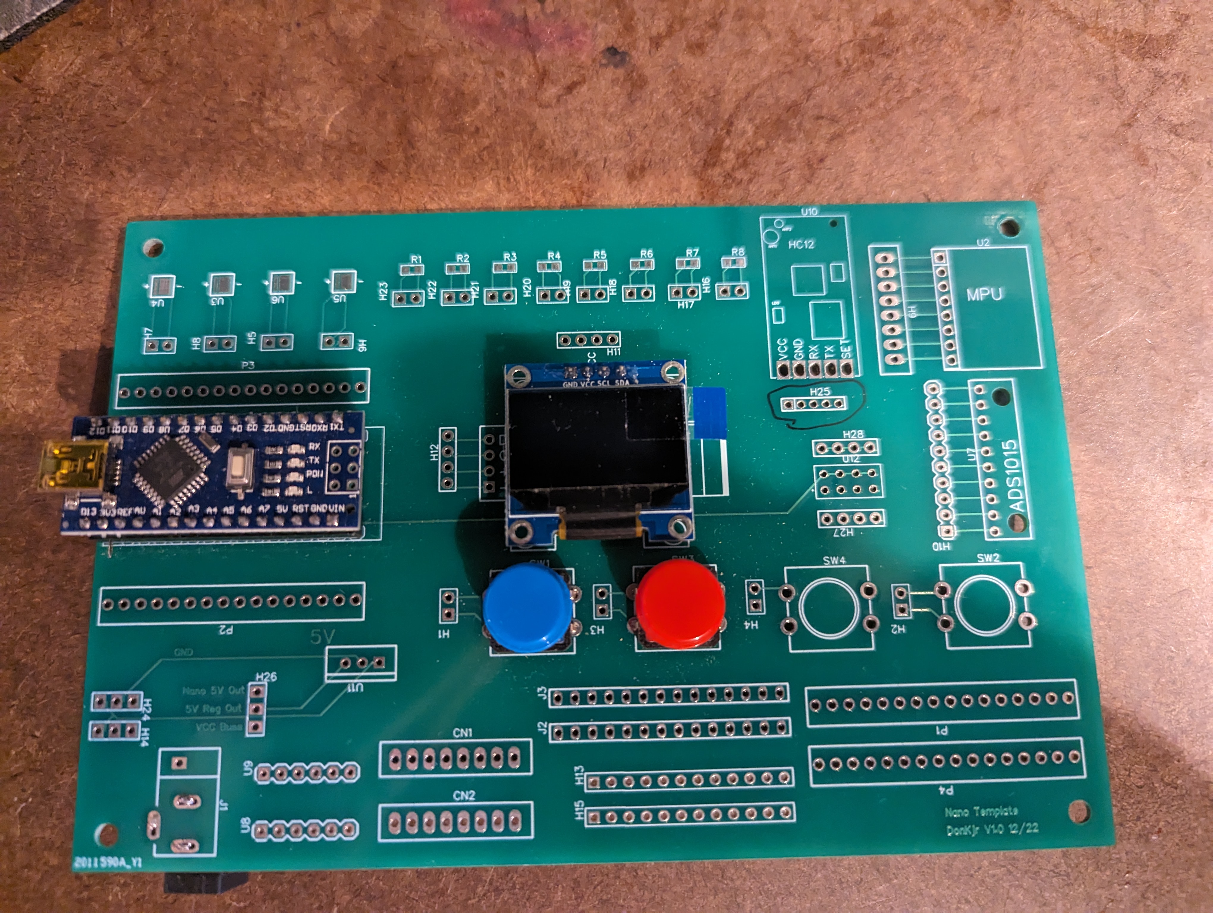

I hate the time it takes to breadboard an embedded controller project. This is especially true of through-hole designs where soldering and wiring the core elements into some kind of matrix board is a pain as is the external cabling. To make matters worse the board layout ends up poorly documented and the form factor followed whatever perf board I have laying around. Then when I am done with the testing I would still have to go design a PCB. The finished proto was much larger than it needed to be because I was still working with through-hole components. Proto-boarding SMT is challenging.
In the process of moving to SMT and getting to a free PCB design tool chain, it dawned on me that I should go directly to an SMT proto. Even if I had to buy 5 boards and throw 4 away the resulting cost/time/size/reliability benefit would be worth it.
I landed on EasyEDA for the toolchain as they provided the capture and PCB design tools and made it really easy to order boards at a reasonable price.
On my way up the SMT learning curve (still climbing), I realized that these controller projects always included one or more of these off-the-shelf modules:
  • An Arduino module (most of the time a Nano, Wemos, NodeMcu)
  • One or more sensor modules; current, hall, switch, accelerometer, A/D, various radio
  • Local display: 64 & 32 char
  • Switches, buttons, LED’s
  • Misc: resistors, caps, inductors
  • Multiple sizes of .1 pitch connectors
  • Power: 12V, 5V, 3.3V regulators
I also realized that most of the time the interfaces were:
  • Direct I/O to the processor
  • I2C
  • Wifi
  • Radio i.e. 433mhz
So I set out to design a universal [usually there is no such thing] PCB platform that I could build most any project on by socketing and soldering modules and components. I would somewhat standardize on components and modules but still be able to hack unexpected modules into compatible sockets. I expected this board would be larger than a custom design could be. If I wanted to go to a production size and configuration it would be a simple matter of returning to the PCB platform, making a copy, deleting parts, and ordering the new form factor.
Common busses are routed on the PCB and can be cut loose or rewired as needed. Parallel pads/holes exist to facilitate making the connections between parts and I/o connections with discrete wires. I like to use wire-wrap wire. Power buses are configurable with jumpers.
In the event that a new module, that has a different pinout, is needed, you can plug it into one of the header rows and wire it up.
Here is what I came up with:
This is a photo of the first version. I have not ordered or tested the newest version.
