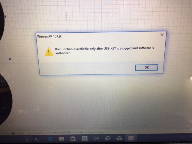

it all started over the weekend when I tried to install Whisperer to cut a project that another kind member her made for me. It was a complete failure when it came to installing whisperer, I will say that it could have been me when I attempted the install but followed all of the steps only to have the software not work. I then went through all of the steps to remove whisperer and attempt to get the stock software to work only to run in to more problems, I have removed all of the software and going to the root file on the c drive to make sure all files had been removed after doing the proper steps to remove the software. after doing a fresh install of the stock software all 3 then ensuring that they are all in the proper place I have gone on to try send a file to either engrave or cut and I am now getting the window that pops up that indicates that the dongle is not installed on the computer. I have done restarts to make sure that the computer see’s all of the software, and hardware properly, the window also pops up indicating that the machine has been recognized and initialized and I also checked to make sure that the board serial number has been typed back in. I have also gone to the software writers website to look for anything that would help, but unfortunately I don’t read Chinese, so there has been no help there. I hope that I have covered all the bases that would need to be covered to describe the issue. Oh buy the way now after doing a reload of all the software only one of the 3 programs will open, previously I could open the program that had all the samples, but now it wont open, also when I open the main program and go to the cut or engrave window it will let me initialize the machine and the cutting head moves, however when I go to send everything to cut or engrave that is when I get the message that the dongle is not connected. If you read any of the post with the help from the other member you will be able to glean a little of the frustration. I hope that someone can help I don’t want it to come across that whisperer is not a good way to go, for most it might be for me well, !!

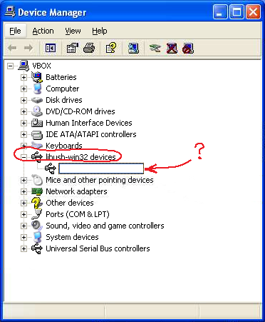

Here is something to try:
  1. insert the usbkey into the computer
  2. go back to the “Windows libUSB Driver Removal” instructions.
  3. Follow the instructions to step #3.
  4. Do you see anything under “libusb-win32”? There may not be a entry for “libusb-win32”. If there isn’t an entry you can stop here.
  5. If there is something there you probably need to remove it using the remaining steps in the instructions. (unless you specifically installed something else.)
i an in front of the computer now I havw 2 computers running so that I can read what you have posted and do the operation on the other system I am looking at the screen and what it showes under that setting is the following intel wireless bluetooth but nothing else. should that be there?
I can’t know for sure because I don’t know what other software/hardware you have installed. If you unplug the USB key does the bluetooth item go away? (this is a bit of a long shot)
when I pulled the dongle the other item is still there the intel wireless bluetooth is still there
when I plug the dongle in it shows the lib-win32 devices shows back up

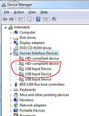

Do new devices show up under Human interface Device when you plug in the key?
It might look different under a different version of windows. what Windows are you using?

I noticed your icons on your board are different than how they show on my screen under the human interface icon a usb device ahows up there when the dongle is plugged in when I remove the dongle does go away
That is probably just a difference in the version of windows.

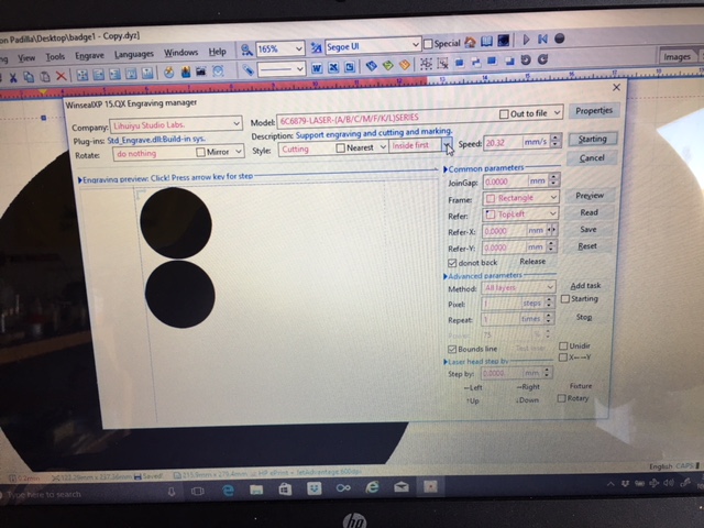

Printing addiction, I did get back out today to work on the software for a couple of hours, I tried to load the programs again and thought I has some success, I will post photos at the end, the computer let me do 2 functions and then I got the dreaded pop up window that indicated that the dongle was not plugged in, I went back and closed the program again and might have even done another restart, with the same results so I think at this point I am going to hold off till I can get the board from Paul De Groot and plug ins for Ink Scape I think in the long run it will save me a lot of frustration and it will also give me time to take the pointers you gave me on how to create the items that you created for me, and I do thank you for that. I asked me son if he would mind holding off for just a little while and he is good with that. Following are the screen shots and photo of the test I ran of your creation on paper, and again THANKS for ALL the help. And I guess that it will only let me do one image at a time.
