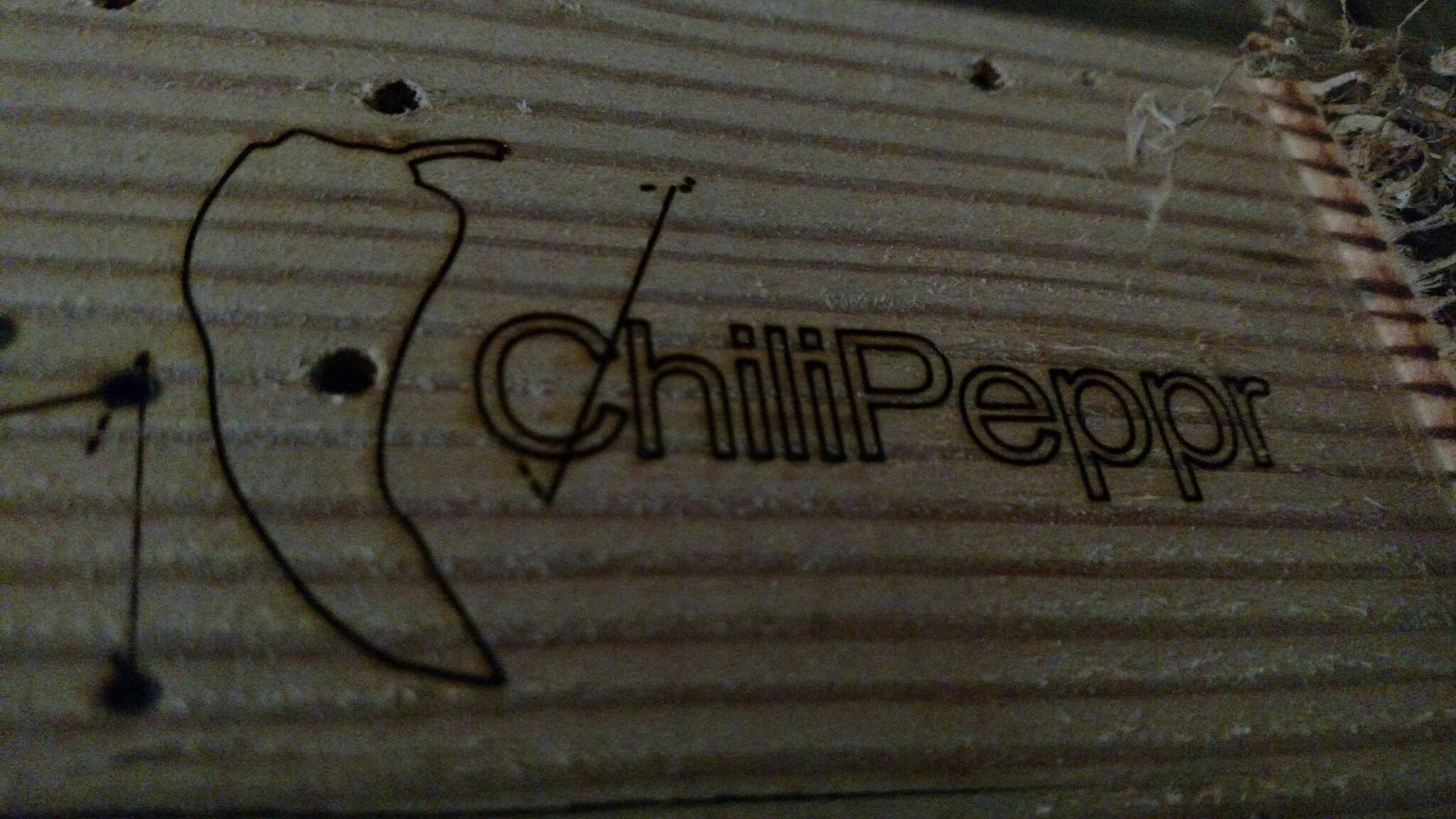

@jlauer Been a while…Getting ready to test a laser. Discovered your video showing how to drop an SVG into Chilipeppr, very cool. Comes in mirrored though? Not really hung up on that. I may want to do shading on wood, not sure how laser’s accomplish this. Assuming has something to do with TTL; that being said how do I hook up TTL to the TinyG. The ttl in on the laser driver has blue & white terminals. I would like to control laser’s output with percentage using the M3. If I have to use M7 that’s fine. Using a dedicated to power supply for a steady 12 volts. I am using a 440nm blue 2W laser. Any feedback would be greatly appreciated.
found this nice post but still not clear on TTL
https://groups.google.com/forum/#!topic/chilipeppr/7EfK3A6BJ8A
Take a look at the Font widget in ChiliPeppr or the SVG widget in ChiliPeppr and go ahead and generate the Gcode from that widget. One of the choices when generating is to pick M3 or M7. I also show you how to set your TTL power setting in the widget in the small font next to the M3/M7 radio buttons.
Also, if you take a look again at that Cayenn video in this post, I use a 5A laser driver from http://Aliexpress.com for my powerful blue laser. I use a 3A laser driver also from Aliexpress for my UV laser. Both of those drivers can be hooked up to TinyG directly, rather than the way I did it from a NodeMCU. Both those drivers take a TTL input in which can be hooked up to the spindle TTL on TinyG. Then you literally are just turning your spindle on and off in the Gcode to toggle the laser on or off.
So I connected white line of ttl to spindle and blue to ground. White would be hot in traditional wiring. Voila!
