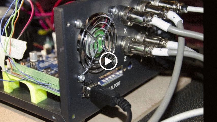

A tour of my modified 3020T CNC Router and a description of a problem I’m having using the touch plate homing cycle
Awesome video. Love the mod. Ok, my first thought is that you are actually fine and that the Z position known by TinyG is correct but you are not getting a position update for some reason in the UI. I would suggest you manually jog up in the Z by 1mm and I bet you’ll get some position updates and thus you’ll see you are fine. It almost feels like the signals are coming back out of order. What version of firmware are you running? I can’t tell from the video because it’s blurry.
Thanks! In the video towards the end, before I re-initiate the probe cycle, I actually jogged it up about 5 mm before hitting run again, which I guess is odd because that should show on the axis display too right? I had also tried jogging it across x and y too just in case, but no dice. The firmware is 440.18, and here are the commands that were sent:
