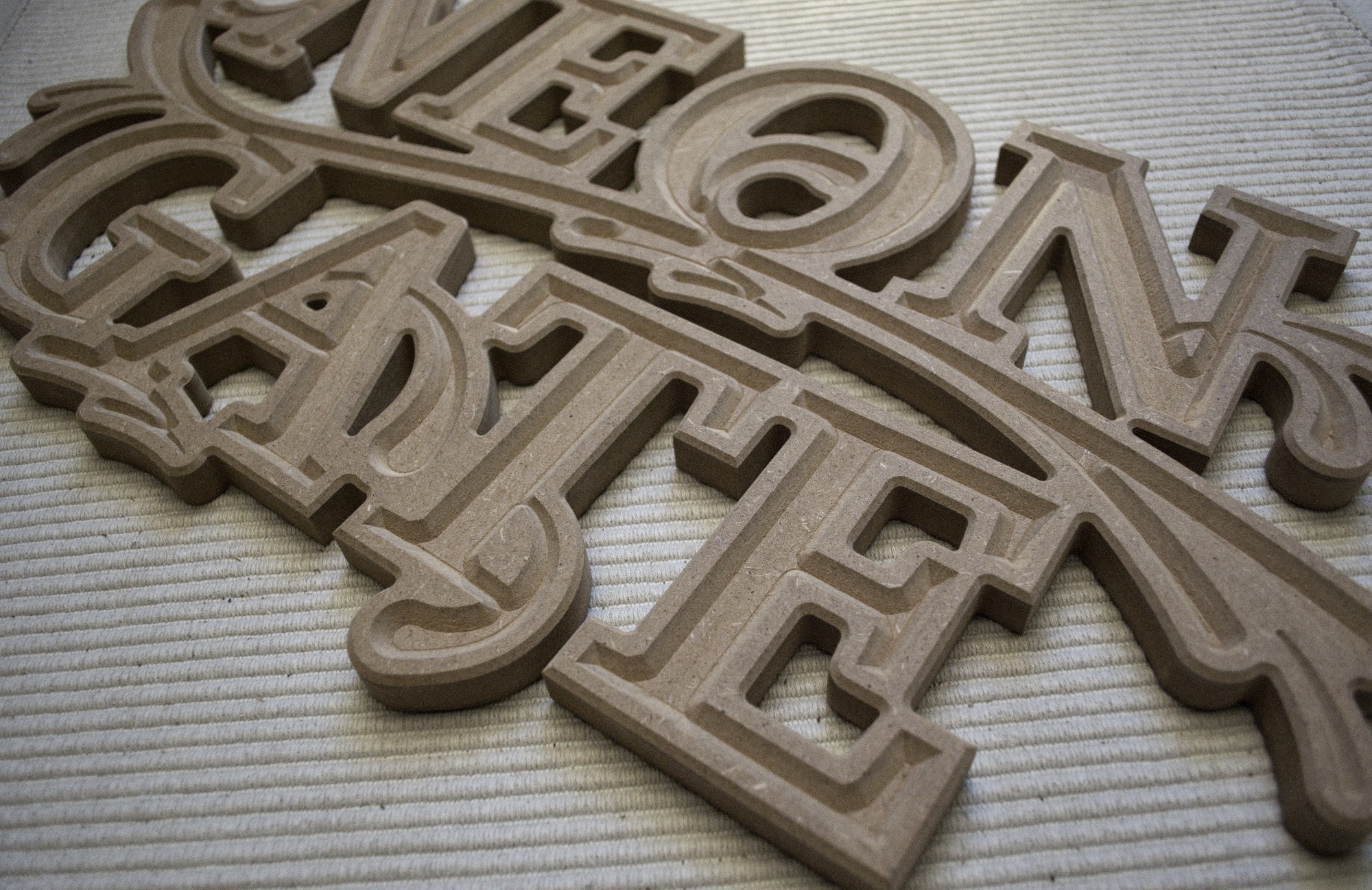

A typographic demo-piece with pockets and V-Bit bevelling for my wall.
A typographic demo-piece with pockets and V-Bit bevelling for my wall. I want to paint it in white and neon orange. Here is a picture of the raw and unfinished milling…
Nice job, did you use vcarve software to make it?

Very nice! Crisp, clean lines!
@Eric_Edwards no, just two inline and outline v-Bit paths in different depths, one pocket for the letters and a manually reduced path for the inner v-bit. I do my dxf work in draftsight and use a script called dxf to gcode for the cam job --> http://www.christian-kohloeffel.homepage.t-online.de/index.html
