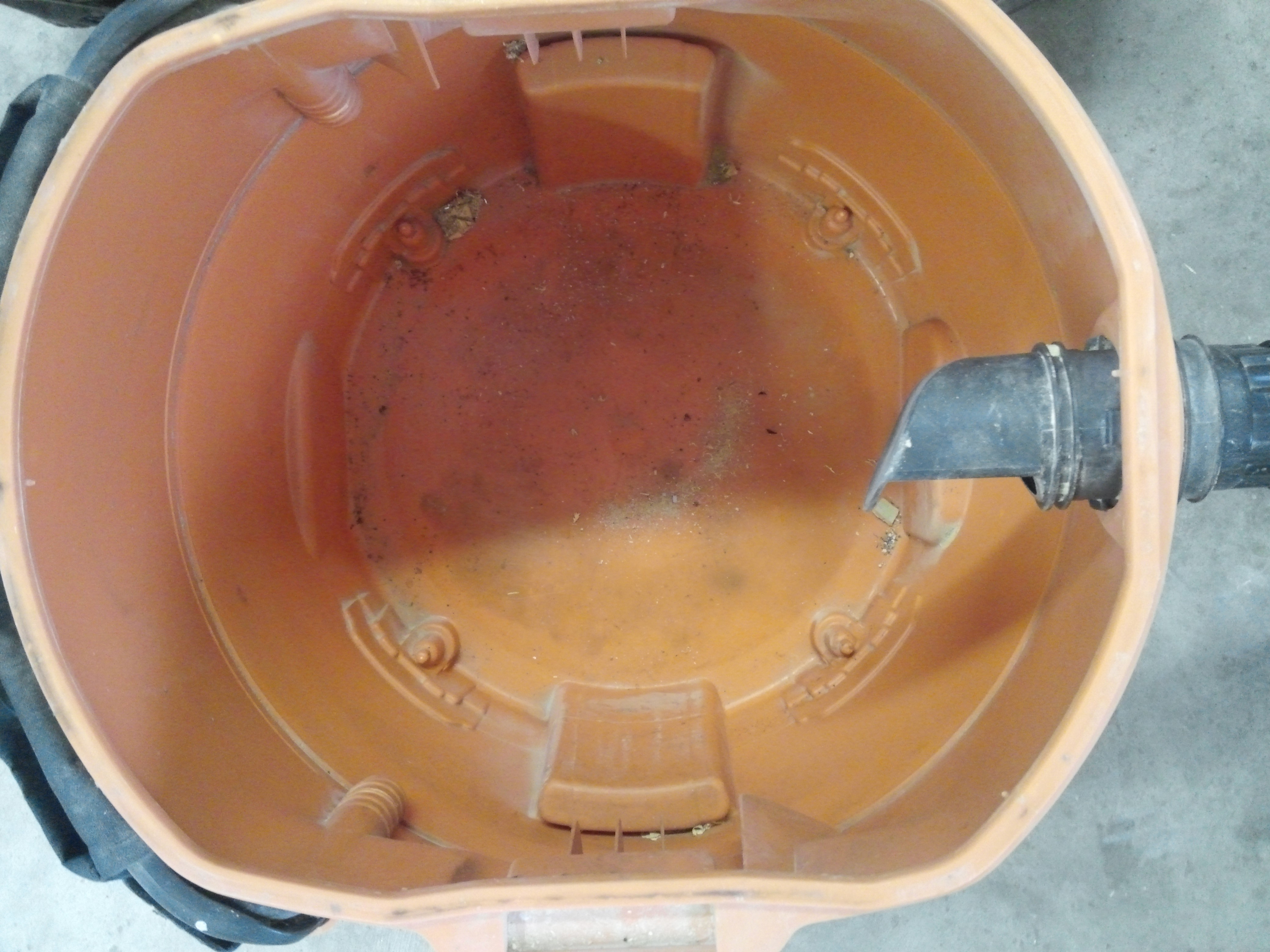

A while back I posted pictures of me cutting a Thein dust collector, which I will call the 1.0; it did not work, so I cut a new one on my CNC, and these pictures show how well it works. #1 is the 6 hp shop vacuum, #2 is the Thein collector, and #3 is the deposit can under the dust collector, totally successful!

I built one also and it worked but left lots of fine dust. Got into everything so I replaced it with a Grizzly 1hp cyclone moving 1025 CFM. Now I have no dust. The first one was ok but I could not move enough air to use it well.
@Daniel_Alderman1 I would like a full size dust system, but that is expensive. Did you incorporate a larger diameter hose system as well? This was pretty low cost, but I agree it is less than a perfect solution. Perhaps I should keep the fine dust bag in the shop vacuum also?
I would keep the fine filter as it will hstop what doesn’t fall out.
The shop vac cannot move enough air fast enough to do a good job.
