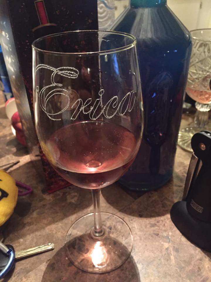

A wine glass I engraved for my step daughter...it turned out great.
A wine glass I engraved for my step daughter…it turned out great.
Nice
@ED_Carty …thanks brother…lol…the one I made for my wife broke while I was engraving it…I was to close to the rim.
See we all learn. I acid etch glass myself…
@Scott_Thorne Much more time consuming tho i believe to acid etch
@ED_Carty …the one in the photo took about 15 seconds.
yea way faster… ha ha
mind if i ask what setting were you using
Cutting…50mm/s at 8 mA.
Thank you
Did you use a rotary table? Or the “rice bowl” method? I’ve seen nice things done without the rotary, but this one seems to wrap the curve a bit so I’m just curious.
I’ve got a rotary attachment.
