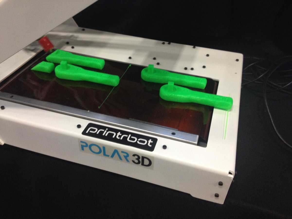

A working Printrbelt. There are a couple of videos on Polar3D Twitter account but
A working Printrbelt. There are a couple of videos on Polar3D Twitter account but I could not get them to post here.

Super intriguing. I get that it’s printing while the surface is moving, and it’s an auto ejecting print surface. How do you determine the ideal angle?
Also the grain direction is interesting! I do a lot of solvent welded assemblies to mix grain directions. This is an interesting compromise.
@Robert_Swarner the angle shouldn’t matter much, but belt speed does.
How is this sliced. The geometry makes sense but the y is treated like the Z and moves in a single direction. But is it a simply as placing an object at an angle upright on the buildplate ?
The Printrbelt was my first try at this so I just copied Bills 35 degree angle he used. At first I drew 45 degrees, but the tip had to be turned down and I just couldn’t imagine it working from the drawing. So 35. I haven’t tested other angles. Thinking about building a version to test other angles.
You just rotate the model 35 degrees and the post processor shifts each layer a bit. The layer shift and the z belt move ads up to the appropriate layer height down from the last position.

I amusing it now w repetier. Any host can run it, it’s the slicing that is tricky. Bill provided a post processor that plugs into repetier. I just didn’t want to say “it’s confusing”… the cloud makes it easy. And I didn’t want to say it works out of the box w any host software… it requires special slicing.
