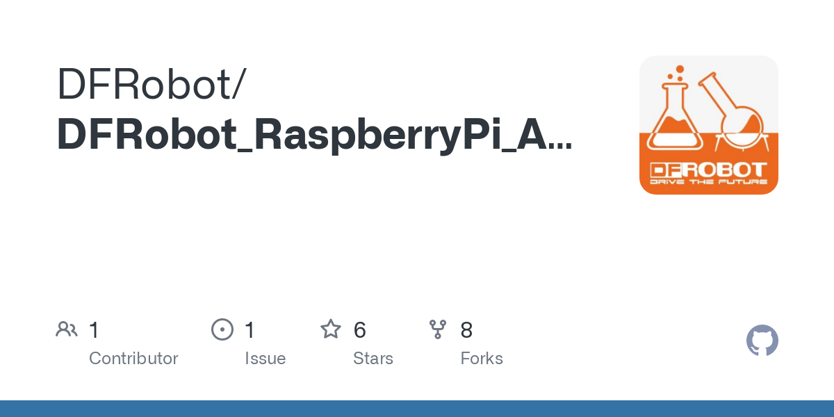

In the link to the RPi library it says that only Pi-1-2-3-4 is supported, nothing about Pico, unfortunately.

The library (GitHub - DFRobot/DFRobot_RaspberryPi_A02YYUW) for this sensor ā€œdoesn’t fitā€ my Pi Pico W with Thonny and Micropython.
