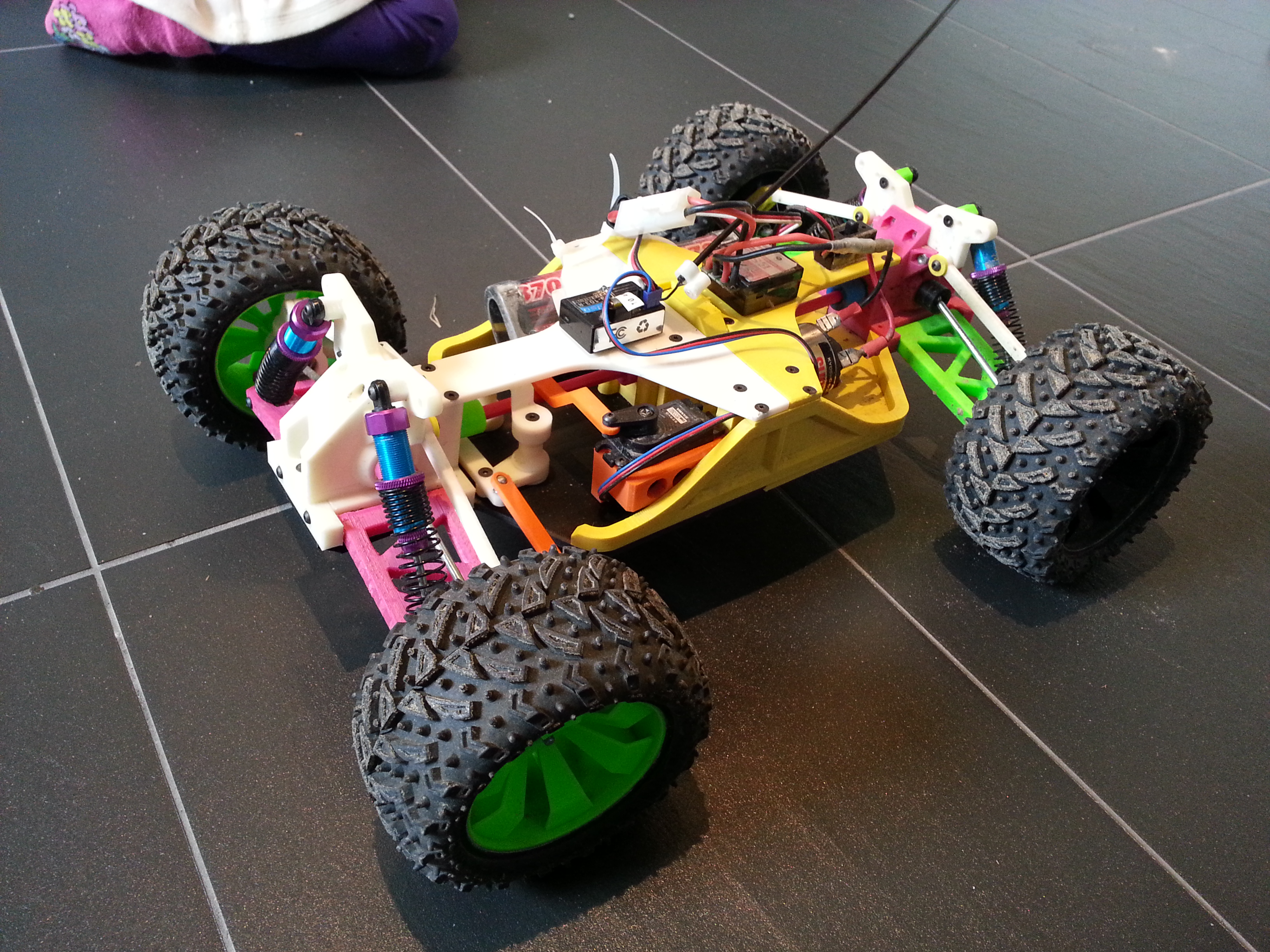

I ordered strong black ABS from Formfutura and should do some testing with that when recieving it. If you are interested I could give some feedback in my findings.
But my focus now is to make something about the heating from motor that soften the interface. I made mine in PLA and the first thing i should try is to make the diffcase in ABS and see if the higher glass transition point and some isolation(gasket) in the interface could do any good. Otherwise i think I go for a aluminum flange that screws into diffcase.
If you’re having problems with heat from the motor… why not use a heatsink for the motor and/or a fan? Looks like you might need to cut (or just not print!) some of the top deck so that a heatsink would fit.
I have considered that to and I have actually ordered one from Conrad
http://www.conrad.se/KYLELEMENT-TILL-MOTORER-TYP-540-MED-VENTILATOR-TITANIUM.htm?websale7=conrad-swe&pi=235439&ci=SHOP_AREA_19779_1230020
Depending on what motor you have… you can use thermal paste to get a good seal between motor and heatsink. Use the same stuff you use to get a good seal between cpu and heatsink.
Other suggestions - infrared digital thermometers are pretty cheap now. £10 ish for one off ebay. You can use that to check temps of the motor after sustained running (temp after load). 160F / 70C should be a guideline max temp for the motor. I don’t know what temp causes you a problem - but if you’re seeing higher than 70C then you likely need to look at your gearing.
Lastly are you running brushed or brushless? brushless systems are pretty cheap now, and have good power /weight. i’d guess a cheap brushless system will run a lot cooler than a cheap brushed system - a basic EZRun system will give you 300W.
What temperature causes the problem?
The glass transition temperature is around 50C for PLA. So I think that is the main problem here.
Maybe you can also use ptfe plastica, as used in reprap hotends, could act as thermal jam
It seems that the motor goes too hot. I don’t know if the lipo battery are are the cause or the motor is defect. When I look at the brush cables it looks like they have been around the melting point. Thinking of buying a brushless motor. Any sugestions for a cheap good brushless? The brushed motor is a standard 19T 540.
Good cheap brushless? You will need a brushless ESC and motor. You can use existing nimh batteries, you don’t have to use lipo.
Suggested - for a 1/10th truggy 35 or 60 amp ESC and 9, 10 or 12T EZRun brushless motor. turns don’t really apply for brushless motors - the thing to pay attention to is the kv rating - something between 3 and 4000kv would be good.
