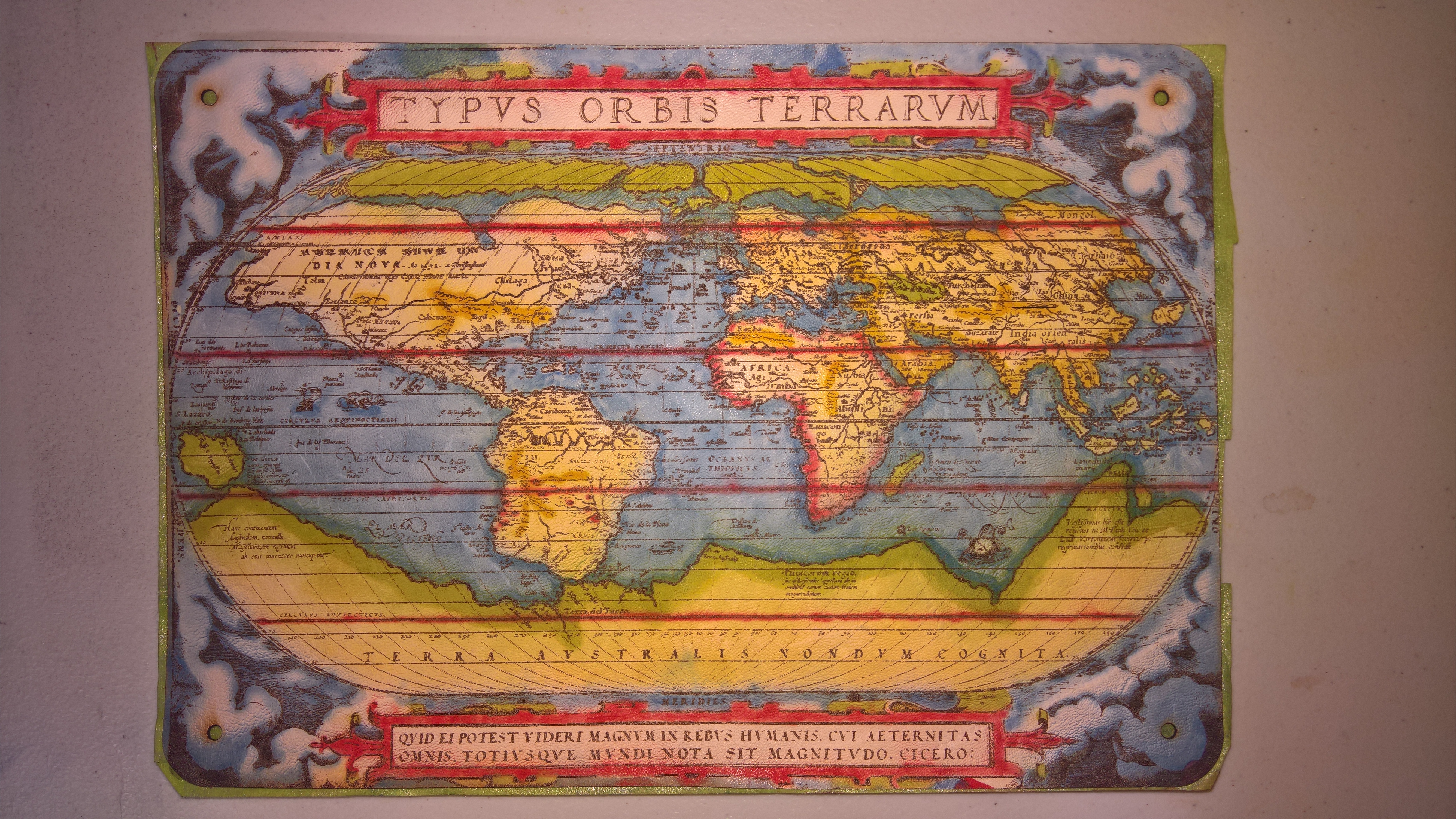

About a month in the making (design wise) & finally lasered yesterday,
About a month in the making (design wise) & finally lasered yesterday, then airbrushed today.
Way too much work involved haha.
Originally shared by Yuusuf Sallahuddin (Y.S. Creations)
Well, here’s another part to my current project. Thanks again #LaserWeb for your spectacular job on engraving the imagery.
Image was processed in Photoshop first, from the colour image (see photos) to a greyscale image using Threshold (value 50, arbitrary value chosen by what looks good).
So, the size was just shy of 7 inch tall, 10 inch wide. Took about 3-6 hours engraving, as certain regions I had to redo (after super careful re-alignment) as the image came out too light for my liking. I think the main engrave (1st run) was about 3 hours (something like 2.9 million lines of gcode).
So, after all the engraving (yesterday), today I sat down for the last 3 hours airbrushing it. 4 colours, leather-dye (thinned 10:1 with Methylated Spirits:Dye).
I will share Original Image, Pre-Processed Image, After Engrave, After Airbrushing.
#Ortelius #1570 #WorldMap #LaserWeb leatherwork #Airbrush

@donkjr @Jim_Hatch Thanks guys :slight_smile: I’m thoroughly satisfied, although the colours only vaguely resemble the original.

Epic! Won’t the dye darken up over time?
@funinthefalls Thanks Anthony.
@Alex_Krause Not this particular dye, it basically holds its colour well. Usually dyes that darken are known as “antiques”, but they eventually stop darkening (when you wipe it off or seal/lacquer the leather).
