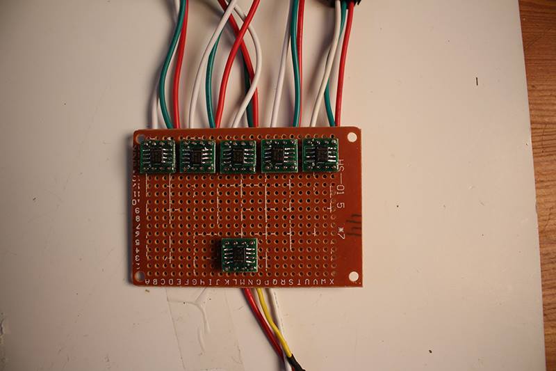

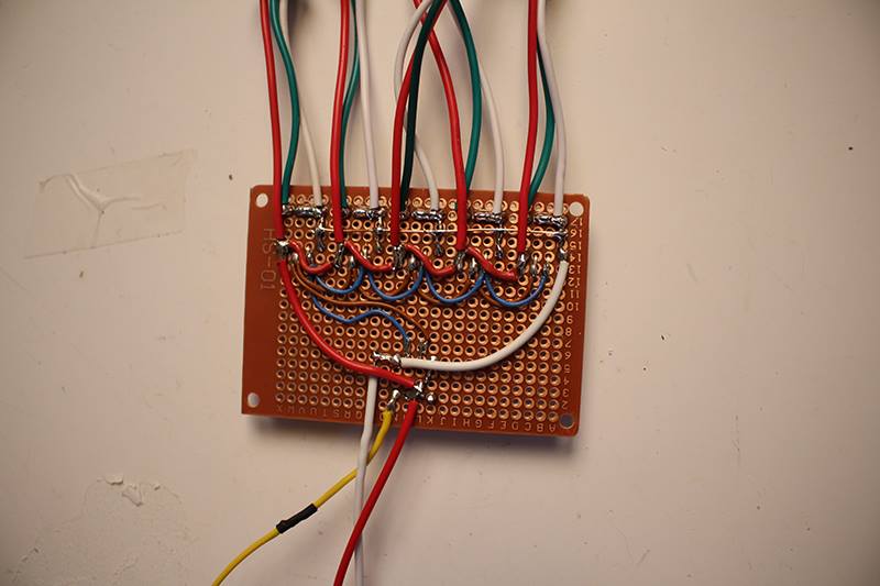

After that, I used SN75176 not to use longer cables, but to split the signal from the output pin into 5, and then I could connect 22AWG cable to drive each piece of led strip apart from the board some 10 meters each. (images of the board at the bottom of the post)

Now I was trying to drive 4 pieces of 2 meters of WS2812b that are some 8 meters away from the arduino board, and again they are all displaying the same program out of a single arduino pin. So I connected a 8 meters long 22AWG cable to the arduino, which is inside of the restraints previously mentioned, and at the end of this cable I connected one of my “splitter board”, to send the signal to the 4 Led strips. It didnt work.
I have the feeling that the SN75176 do the job only if it is connected close from the arduino board, but if there is already a lenght of cable between the pin and the driver (SN75176) the signal is already weak enough or noisy enough for the SN75176 to manipulate it properly.
