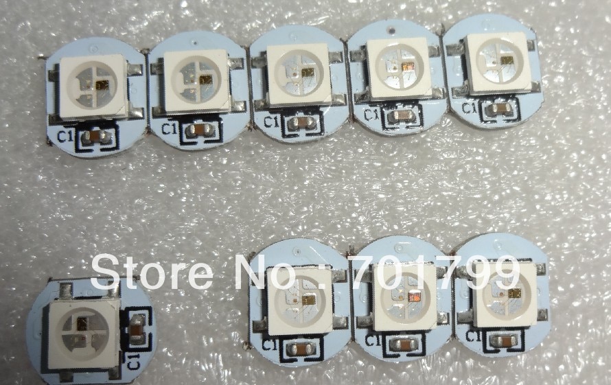

http://www.ebay.com/itm/1000x-WS2812B-LED-With-Heatsink-10mm-3mm-DC5V-5050-SMD-RGB-WS2811-IC-Built-in-/310789319869?pt=LH_DefaultDomain_0&hash=item485c7cacbd
Be interested to know how much price difference is between the above and what you are doing… seems a decent deal?
@Justin_Eastman the design on that one is great IMO … I don’t care for circle design and I also wanted holes for the input/outputs rather then pads.
