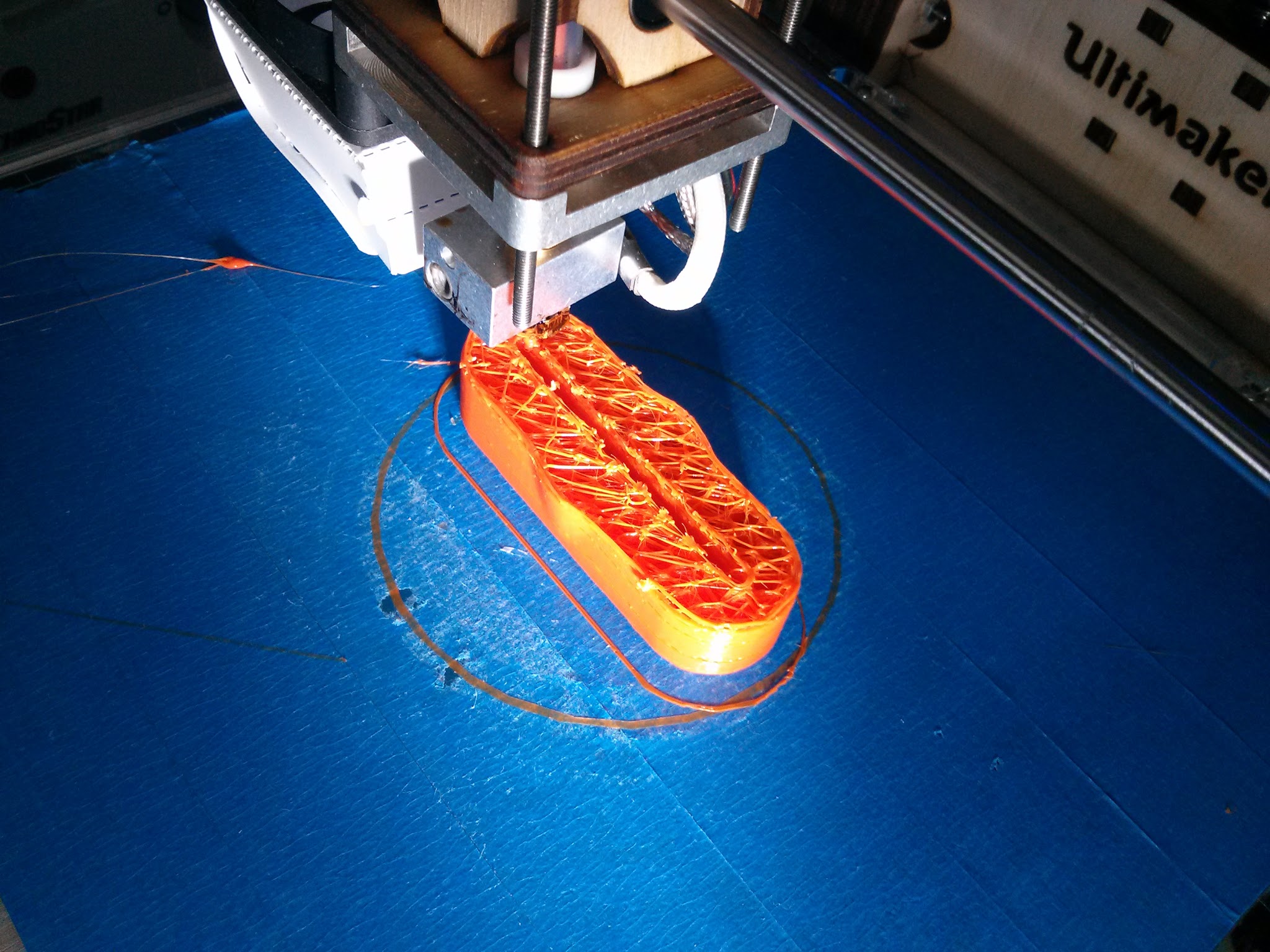

ABS @ 240°C, could it be too hot?
Ultimaker, 100mm/s, natural coloured ABS @240 and PLA @220 work like a charm.
Looks more like your extruder is slipping.
Huh, crap. I turned off retraction, looks better now.
My bolt is clean, pressure seems to be ok too…any other tips you could give me?
