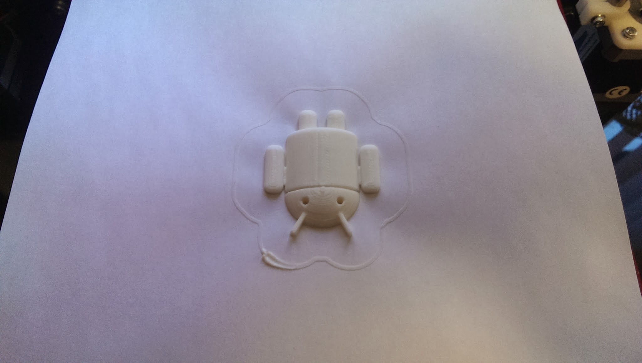

I’m getting some really good results using paper as a base for ABS prints. It has a number of advantages in that its clean, cheap, most people have some nearby, it sticks really well and yet is easy to remove. The only downside is it doesn’t discourage warping. IE the paper just creases slightly as the print warps (as you can see in the photo). Not sure if thats to do with me not having my temps right or not though as ABS is new to me.

Yeah, you’re gonna be close to the flashpoint for paper - right about 230ºC, according to some sources. (And Ray Bradbury.)
I did wonder… I didn’t get so much as mark on the paper except at the start of the warm up swipe where the head was stationary pressed against the paper I had a pin prick of brown.
I guess as long as you stand over it for the first layer you should be good since the bed isn’t anywhere near that temp.
You can hit the paper with a Boric Acid or Borax solution if you are concerned about fire.
I’m not really bothered personally, it didn’t seem to be an issue but I guess if you had some of the ABS that needs to be quite hot it could be.

I wouldn’t worry about paper bursting into flames due to being printed on. The print bed never gets anywhere near as hot as the interior of the extruder, because it cools as it leaves the nozzle, so the paper’s not more than 100 degrees. Even if you leave the nozzle pressed against paper, nothing happens. :slight_smile:
Cheers for the info @Laird_Popkin I did wonder if that was the case :slight_smile:
