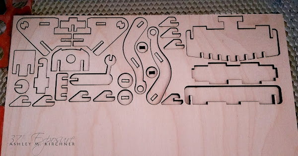

I hope this works. This was yesterday, before the nozzle “mishap”:
Google Photos

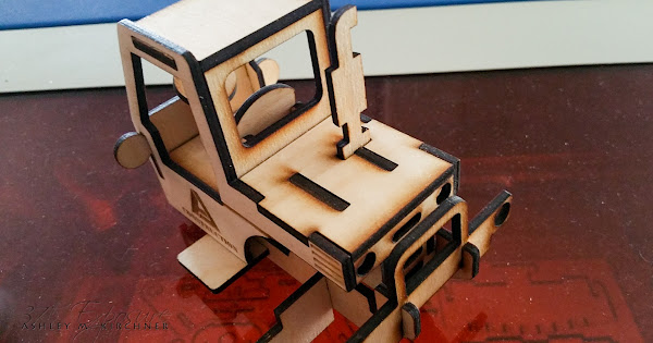

And this is today:
Google Photos
I haven’t pulled the burnt nozzle off yet because I want to do some more cutting/engraving of some pieces that I want done. However, just looking at it, one of the things I think happened is that when the ABS melted, it stretched a bit, bringing the tip of the nozzle closer to the material. It used to float about 5mm above it, now it’s within 3mm. I also think internally it changes as the ‘hissing’ pressure coming out of it is louder, which indicated a more restricted airflow. We’ll see when I yank it off eventually.
@Ashley_M_Kirchner_No Wow, that is actually a massive improvement on the scorch marks. I think you’re onto a winner :slight_smile:
We (I) would sure like to know what made the difference, because it sure is a big step forward.
When you get it apart, I’ll be paying attention to your findings.
