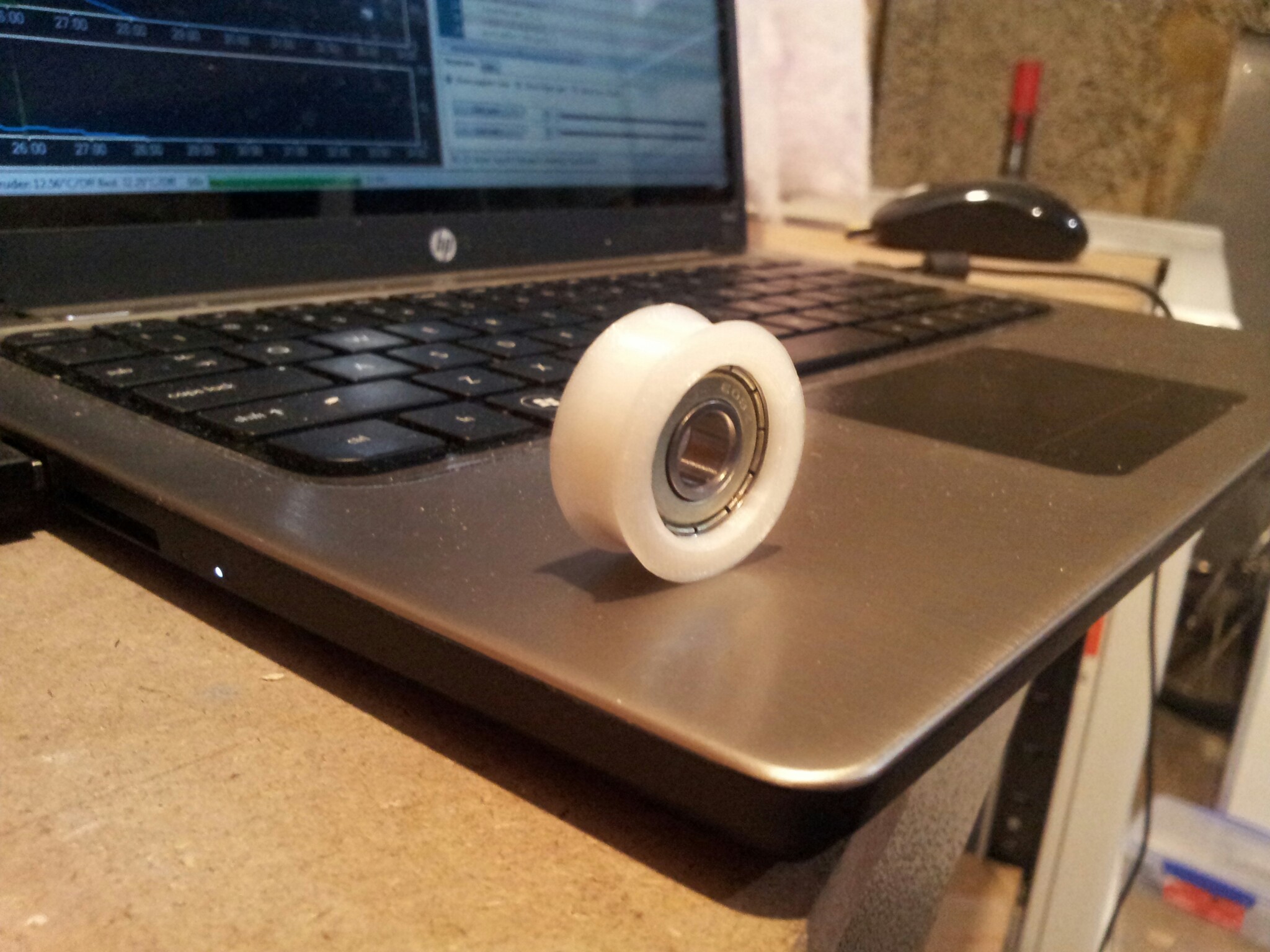

Achievement unlocked at last: near perfect, steamless printing of Taulman 618 despite 74% relative humidity.

I’ve created an insulated drying chamber that is controllable via potentiometer. I’ve found that 40C with the door open is about right to bring the RH down to 20%. When I’m ready to print I move the dried nylon into a second humidity controlled chamber above my printer from which I print.
@Shauki I’m not sure the minimum time, but 10 hours worked.
You’re not doing it right. My system is only 100W. I’ve insulated the chamber. @Shauki
100W x 10hrs = 1kWh x .16 = .16 euro
