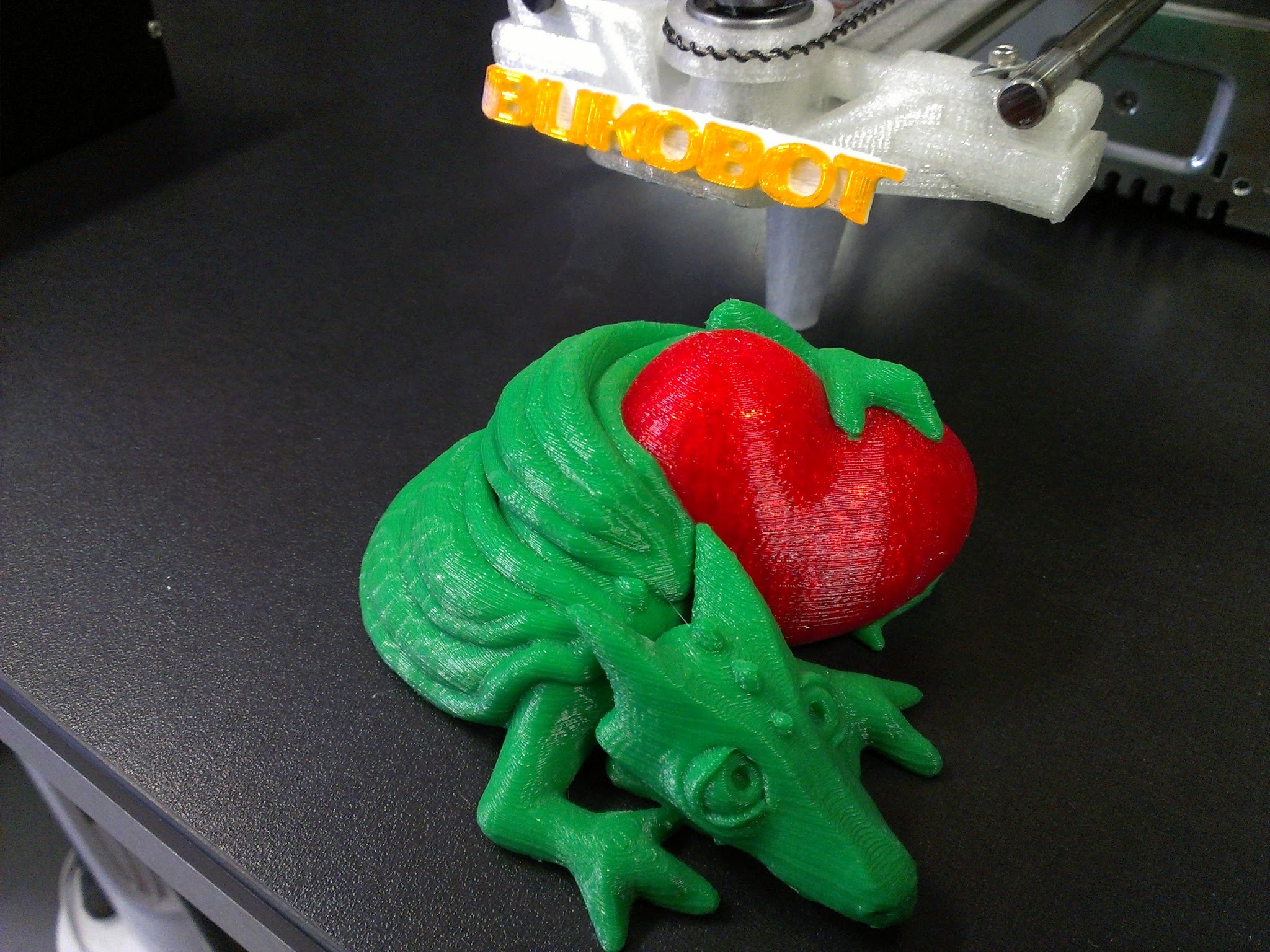

Achievement Unlocked: Perfect 2-color printing with Slic3r.
No cleanup was done on this. Ever notice how the 2-color prints on a Makerbot always have bits of oozing plastic from the other nozzle sticking out? Not on a Bukobot.

Very nice and clean print, are you turning the temps of each extruder up and down before they switch? or doing a lot of wipe moves.

I’m planning to add a dual setup to my MG Prusa at some point. I have a couple of QU-BD extruders that I’m hoping to recycle the hot-ends from and either modify enough to mount on the Prusa or perhaps convert to use in a bowden setup.
The qu-bd nozzles would be great for dual but with such short nozzles be careful not to melt your printed carriage from the heater blocks heat. Also, change to @Whosa_whatsis mod from better performance http://www.thingiverse.com/thing:15718
Thanks for the tips @Diego_Porqueras_Deez ! Yeah I’ve had zero luck with the “drive” portion of the QU-BD’s so some modification will be part of the plan (and I really like the @Whosa_whatsis one you point out, nice and minimal

@Richard_Horne Yes, the inactive extruder is being cooled to a standby temperature to prevent oozing. I’ll post all the details when I have time to do a full writeup.
