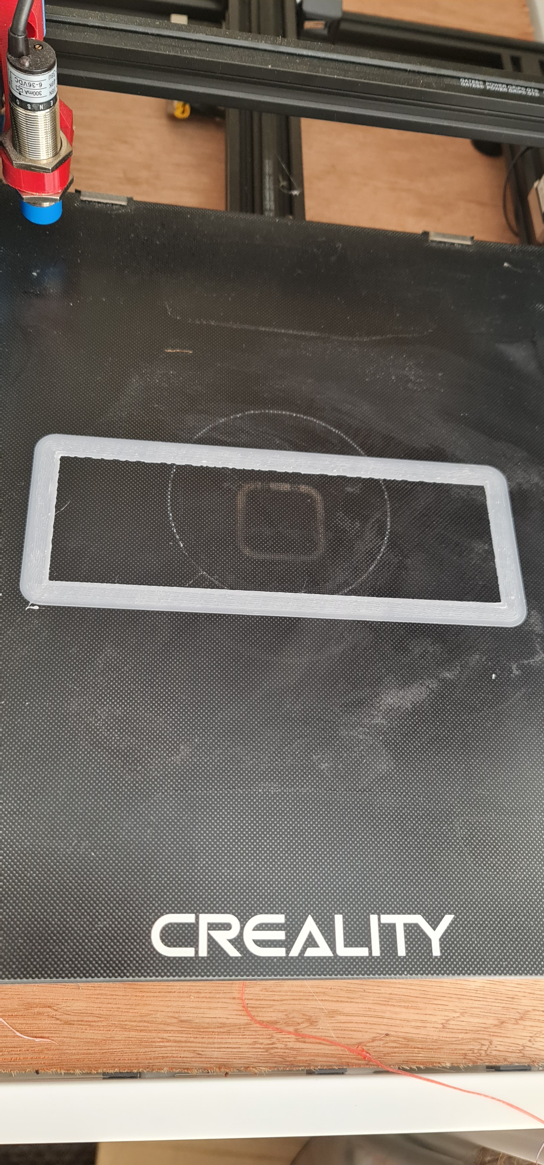

I designed and laser printed a desk name plaque for work. Then printed it, measured it and Fusion 360’d a rectangle. I then printed it with a brim to align the OHP sheet.
I didnt adjust the bed level to compensate for the OHP (I came to this conclusion after some testing)
Layed the OHP on the bed and used water and kapton tape to hold it down.
The result is amazing. This has opened up a whole new world of possibilities!

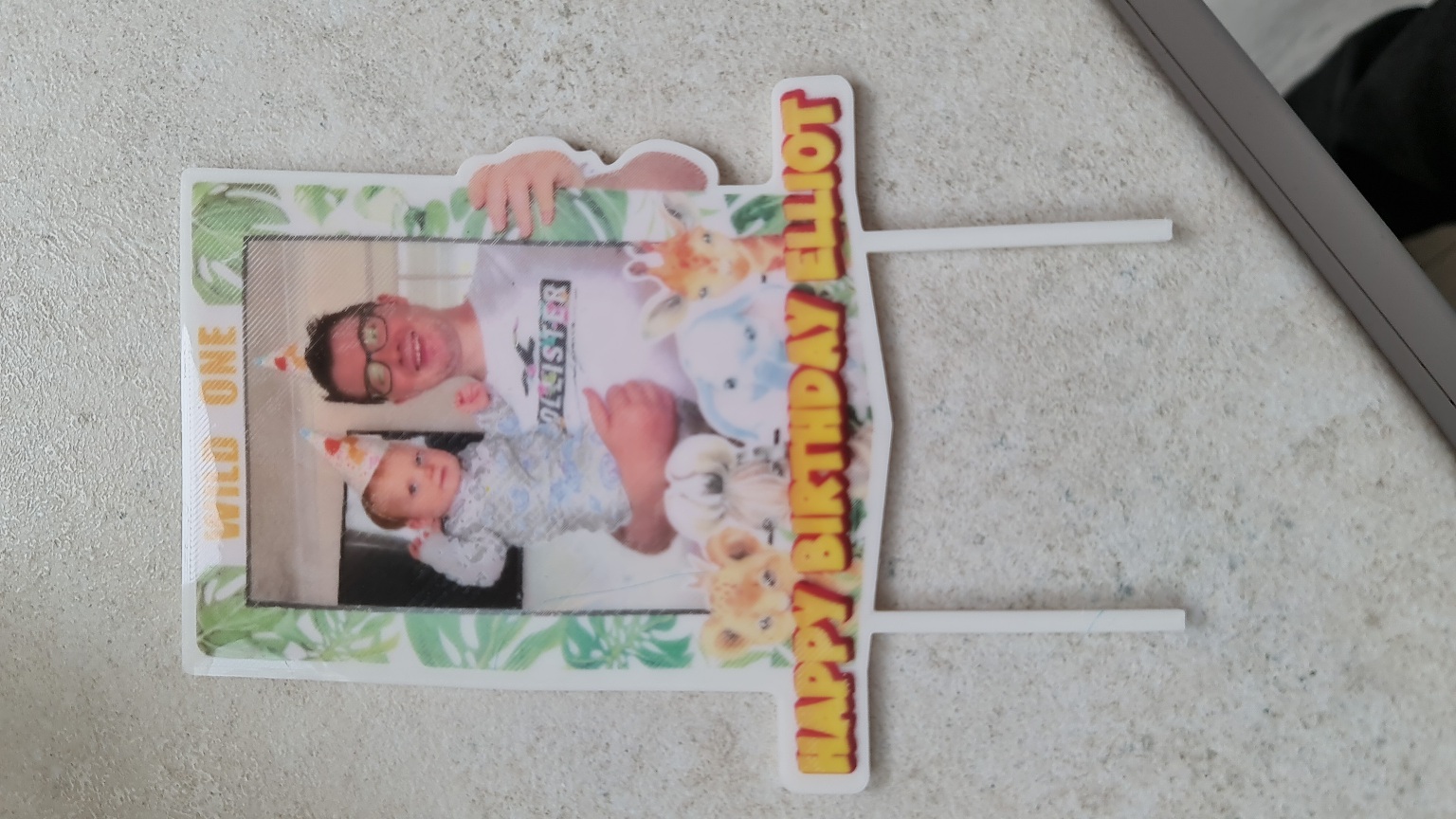

Another example - cake topper.
Now that is just genius!
