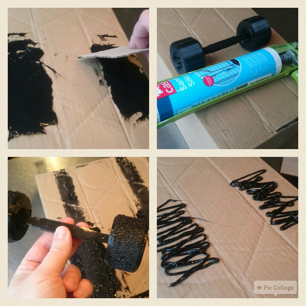

Add more grip to the Ninjaflex tired using Silicone.
an improvement over the glue gun idea that we had from the beginning of the 80’s
like this you wouldn’t even need ninjaflex actually. You could simply print an negative of the tires, fix the rims inside and fill it with silicone.
Aren’t there other designs with a profile for more grip?
@Eric_Crawford ​ there are raintires designed by @Thomas_Palm ​ but they do not increase the grip very much.
