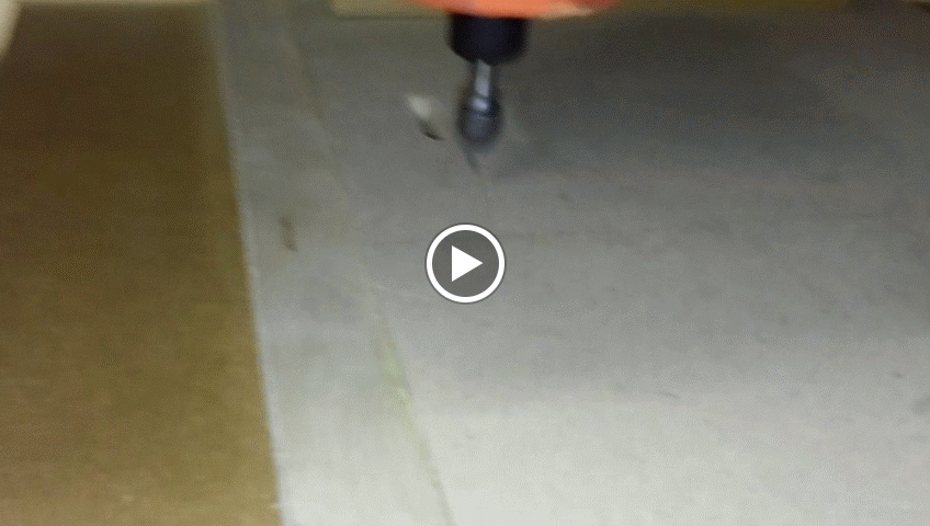

Added my laminate router,
Added my laminate router, now I can cut a mount for my full size router!
Turn down your sound, it is loud. Got to learn how to edit on my LG-Pro!
what brand of router is that?.. It looks just like (other than color) my Harbor Freight trim router. Hows the spindle run-out? i like you clamp better than mine :smiley: mine consists of 2 2.5" muffler clamps… low tech…
@Bryan_Barnes_BBmech7 You are correct Harbor Freight, run out is not bad, used it on my Rockcliffe before mounting here, it will do to cut out the larger mount for my dewalt router. THis is a bit of a kludge, one is aluminum, the other is HDPE. Goal right now is to get all three with easily to change mounts for different work. the Zen works spindle is for engraving and plastics… laminate router for easy wood projects, dewalt for more precision wood, maybe aluminum.
