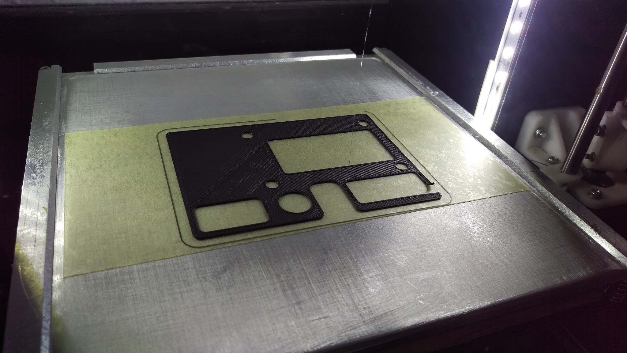

However when I tied it I was baffled… Most people were saying “it sticks too hard” and yet for me, although it was holding the PLA prints in place it wasn’t even sticking well enough to prevent curling (see image below)?
