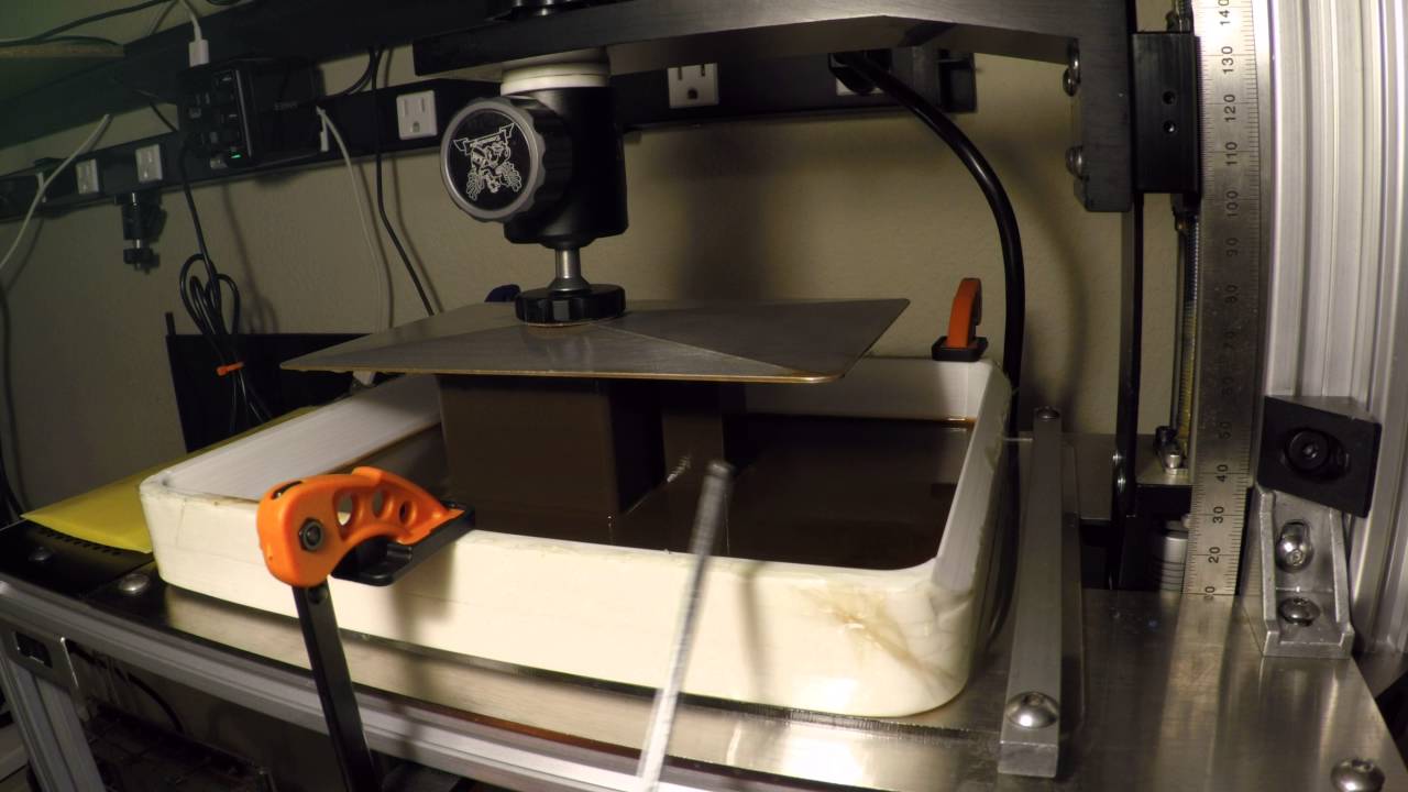

After a couple of iterations,
After a couple of iterations, the simple home-made tape-sealed FDM printed flex vat for SLA resin printing is working out pretty well. After trying a couple of different techniques, got something that worked pretty well. I recommend using foam VHB tape rather than thin transfer tapes. It seals well and is much easier to remove when you’re ready to replace the film.
Video of the vat in use:
Comparison of the vat to other vats I have used:
And to wrap up the series, a video showing how to make one: https://www.youtube.com/watch?v=zSkQQPkm52s
