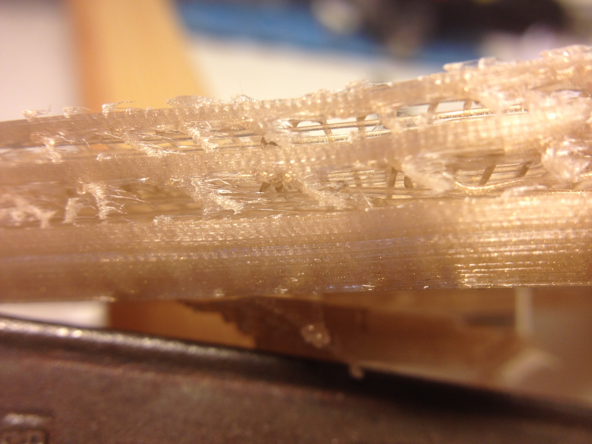

After a weekend of heavy printing (visit the 3D printed nudes blog to see the successful prints) I suddenly found I couldn’t print properly any more.
Intermittent gaps in the layers were the hallmark of filament jamming in the nozzle. The fan on my E3D hot end was still spinning but was rather erratic and much quieter than usual. I should point out to @Sanjay_Mortimer that this is not the fan that was supplied with my v4 hotend which died last year, but a replacement I bought from Maplin.
I disassembled the fan, removing the sticker and a rubber sealing plug and then placed a drop of light machine oil on the axle. After moving the axle back and forth a few times to get oil into the bearing, I switched back on again and the fan was back up to full power.
