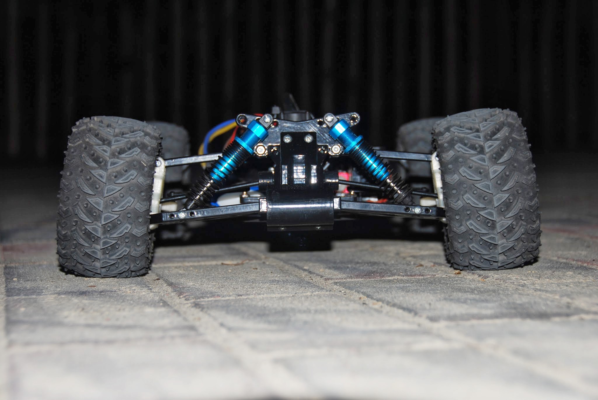

After breaking the steering hub (light crash onto an inert object) i’ve printed affected parts in nylon. Much stronger and easier to assemble. Question is the amount of camber right or did I mix up some parts.
i think you might have the wrong length suspension links, (there is at least 2 different lengths in the files i have) i did the same thing,
Cain Blank: How much camber and toe-in does your car have?
not as much camber as your pic, and i used adjustable steering links so i can change my toe
could it be that you used the rear links in front?
I got some revisions mixed up. I used some B1 wishbones ( I think) and B3 turnbuckles. Didn’t match.
