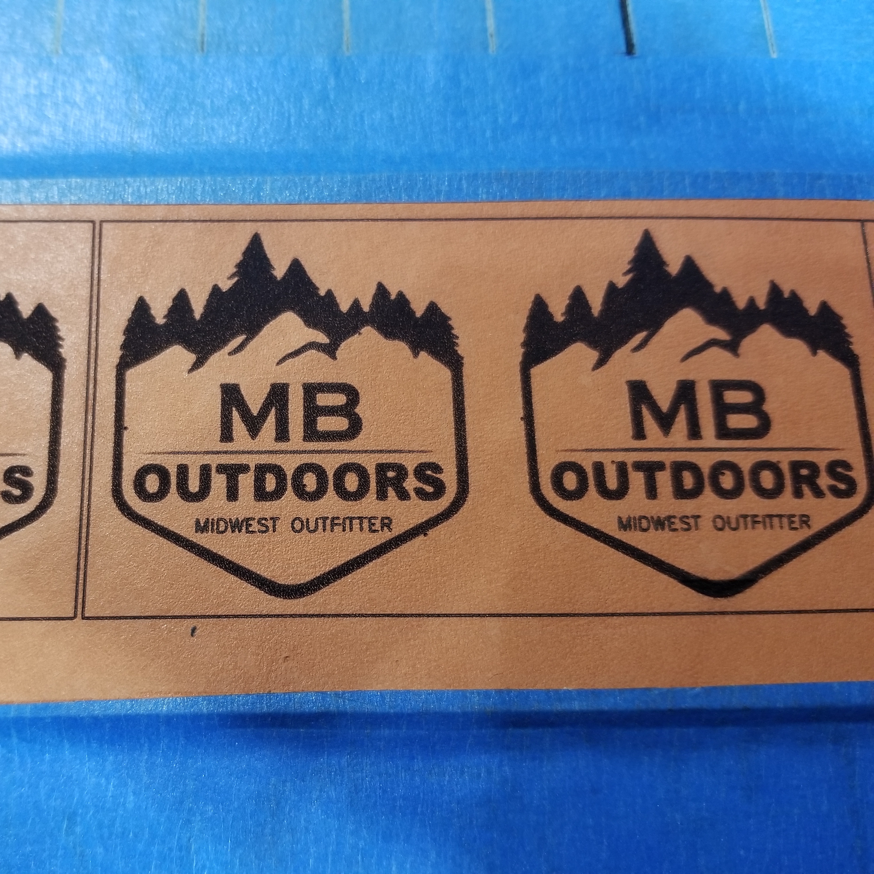

After changing from the stock k40 board to the grbl board I’m get random dots. I’ve changed acceleration, re worked the image from scratch and steps per mm.
Have you run the process more than once and the dots appear in different places each time or the same places each time?
@CPUnltd yes about 30 times now trying different settings. Always in different spots. It seems like they are always next to an engraved portion. They are rarely in the Middle
What about more than once with the same settings? Did the dots still come out in “random” locations or were they consistent?
What software are you using to generate the GCode? Are you telling that software to dither, or threshold when outputting?
@LightBurn_Software laserweb and light burn. I’ve tried greyscale, black and white, and threshold.
@CPUnltd yes. Dots are random. Always seem to be right next to the engraved portions. Almost as if sometimes fireing a bit to early

Well what I thought was solved is not. Both vector images and raster still producing the same dots. I’ve installed a resistor and cap on the PWM line for a noise filter and still no result
Looks like the problem is tied to the $28 setting of 0(default) and other high frequency settings. Upon changing it to 5 or 6 the dots are eliminated. Any insight as to why?
You initially said “the grbl board”, not “the Gerbil board” - the $28 setting is a custom setting for that version of GRBL only, which would’ve been good to know at the beginning. Not all power supplies respond well to higher frequency PWM signals, so changing the period can help, which is what that specific version of GRBL does with $28.
@LightBurn_Software I apologise for this misunderstanding. I’m currently rewiring with all shielded cables. Hopefully this will resolve it.
