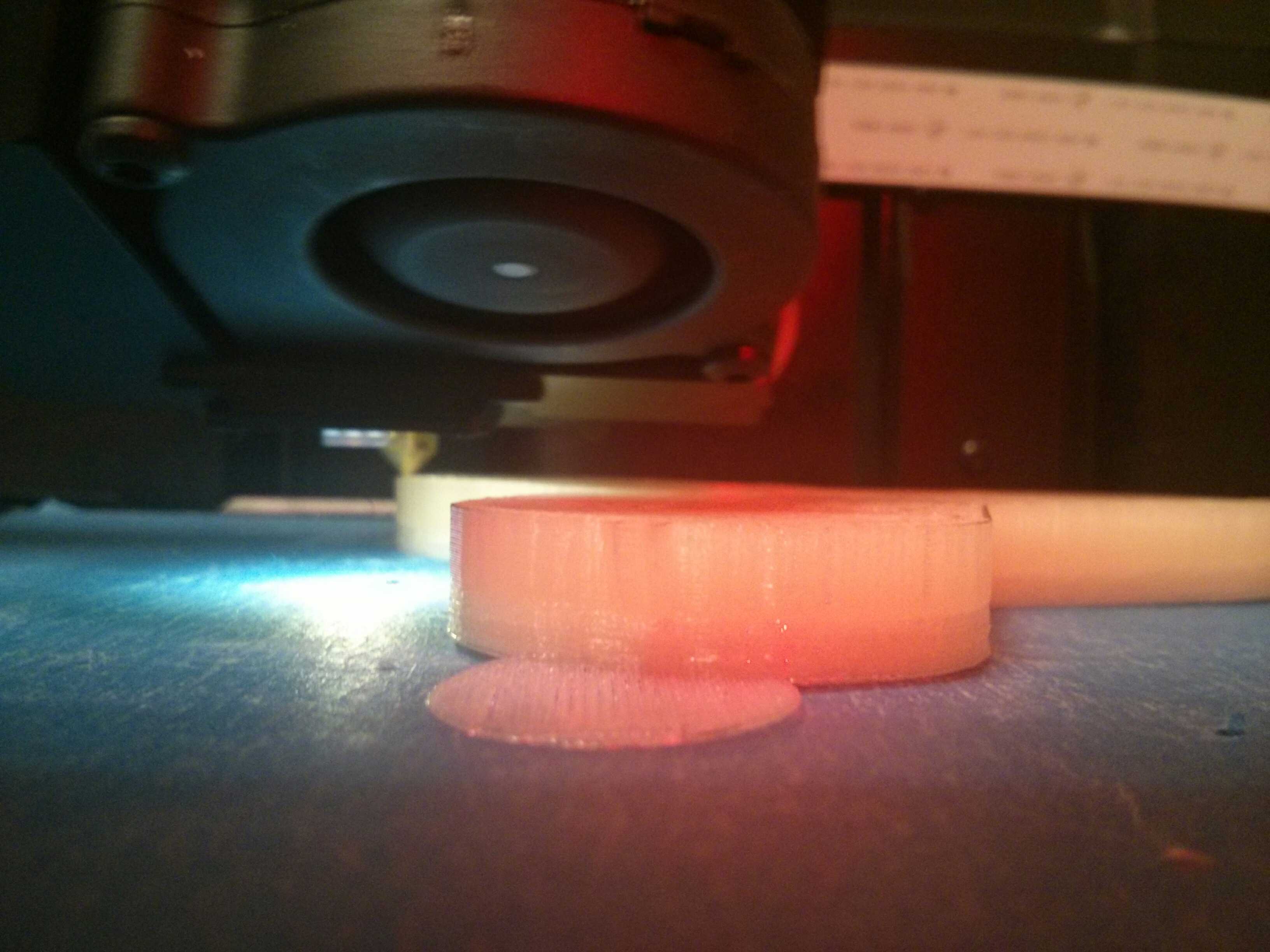

After half an hour of jams I put a tiny bit of canola oil
After half an hour of jams I put a tiny bit of canola oil on the end of my filament. It’s been 2 hours and no jams =D you can see the difference in print consistency in the bottom layers.
So you just dipped the end of filament in canola oil before inserting it into the extuder?
Ya, a very small amount. This is a relatively new extruder, only 30 or so hours of printing on it. I had checked everywhere for clogs and hadn’t found any. A friend of mine suggested the oil.

Yes, correct the E3D people call it seasoning. It really makes a huge difference in all metal hotends.
