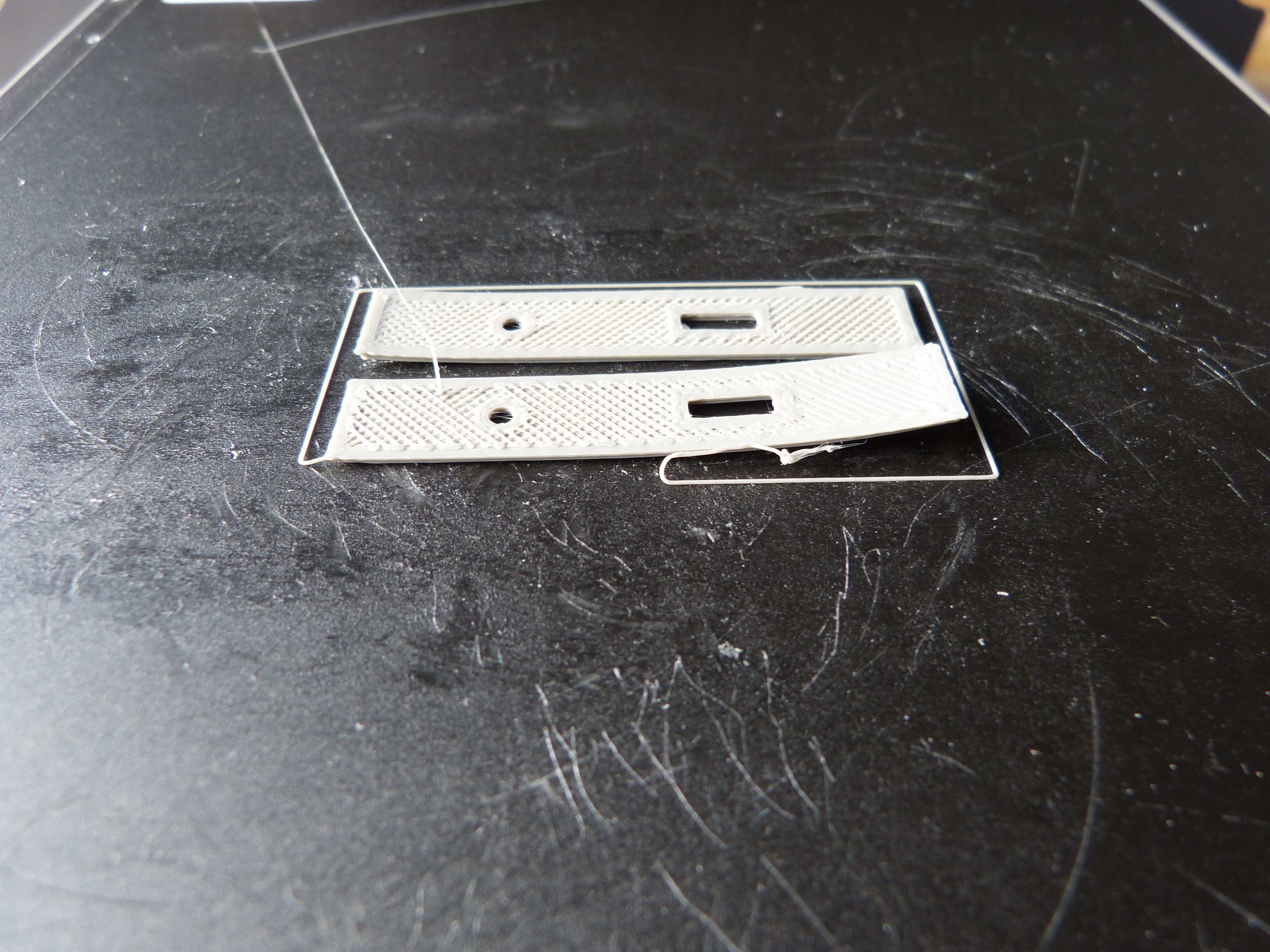

After having printed for eight months without problems on my Hephestos 2, I can’t get a decent print from it anymore because of severe warping (even after a few layers). It started with deassembling and assembling the z-axis because a part on this axis came loose. All operation appears to be normal, the z-axis looks good and the tension on the belts is fine. I use Pritt for better adhesion and print regular PLA at 220 degrees Celcius. Has anyone any idea what could cause this? Thanks.

Looks like bed leveling issue to me. If your front right nozzle set too close to buildtak itself, it could have first layer too thin on that corner and cause to warp

I rechecked the z-offset and it was pretty high so I narrowed it. Now a piece of paper barely fits between the nozzle and the BuildTak. The testrun that I’m doing now (with Filaflex, I don’t have new PLA until tomorrow) appears to be doing fine.
@Step_Cia
Thanks, but I double checked the bed leveling and it’s fine. I followed on @David_Sherwood advice and re-check the z offset and used a brand new BuildTak layer. Still printing but print already looks much better.
My (Filaflex) test print came off fine. Adhesion seems to be back at normal. I think that the combination of new BuildTak surface and adjusting the nozzle closer to the printbed did the job. Will try PLA tomorrow but thanks everyone for your help.

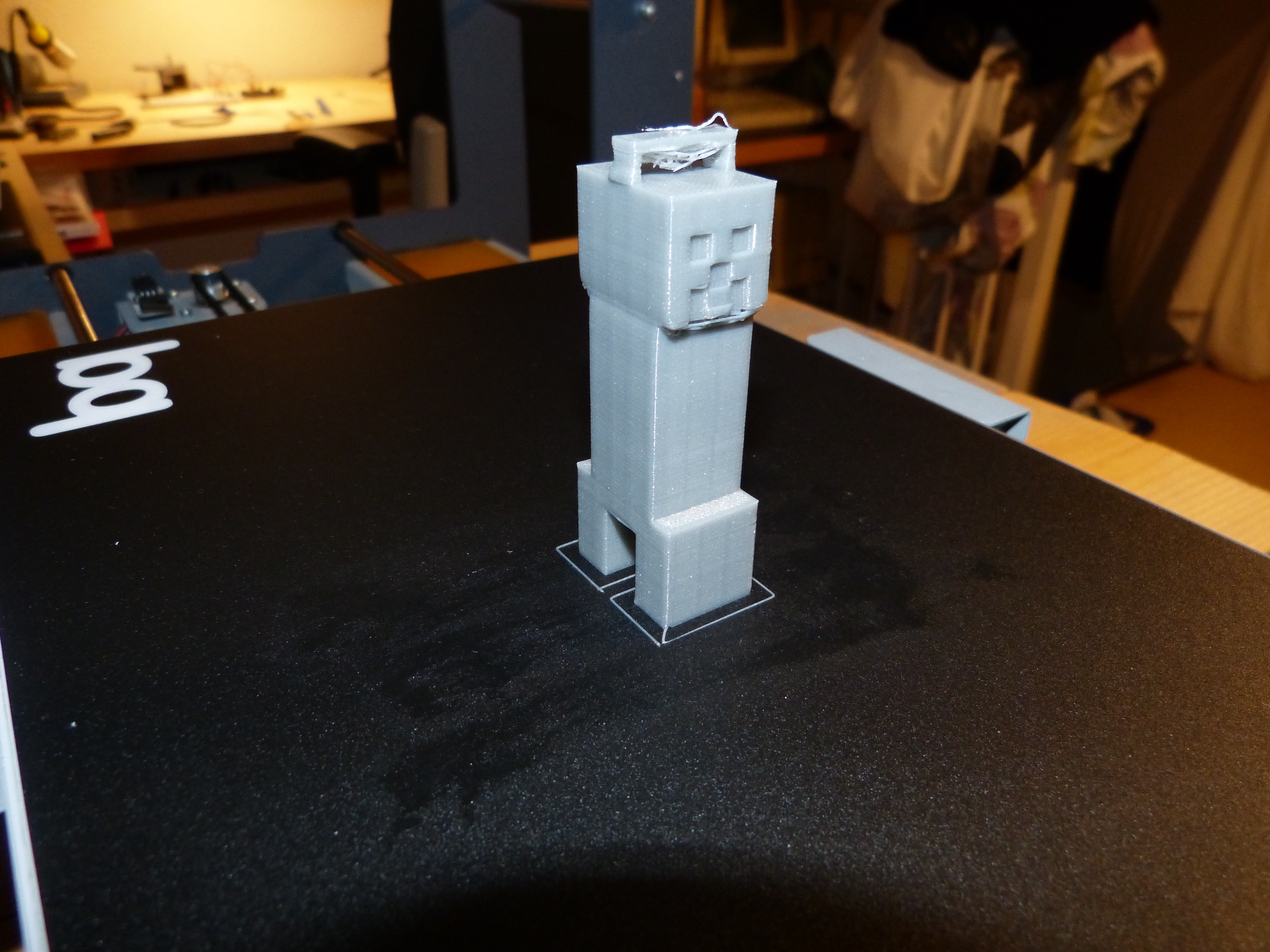

Finally my new roll of PLA arrived and I tried it today. It appears that most problems are gone. I do however have some warping problems on the right side on the printbed. Probably need to do some more bed leveling.
