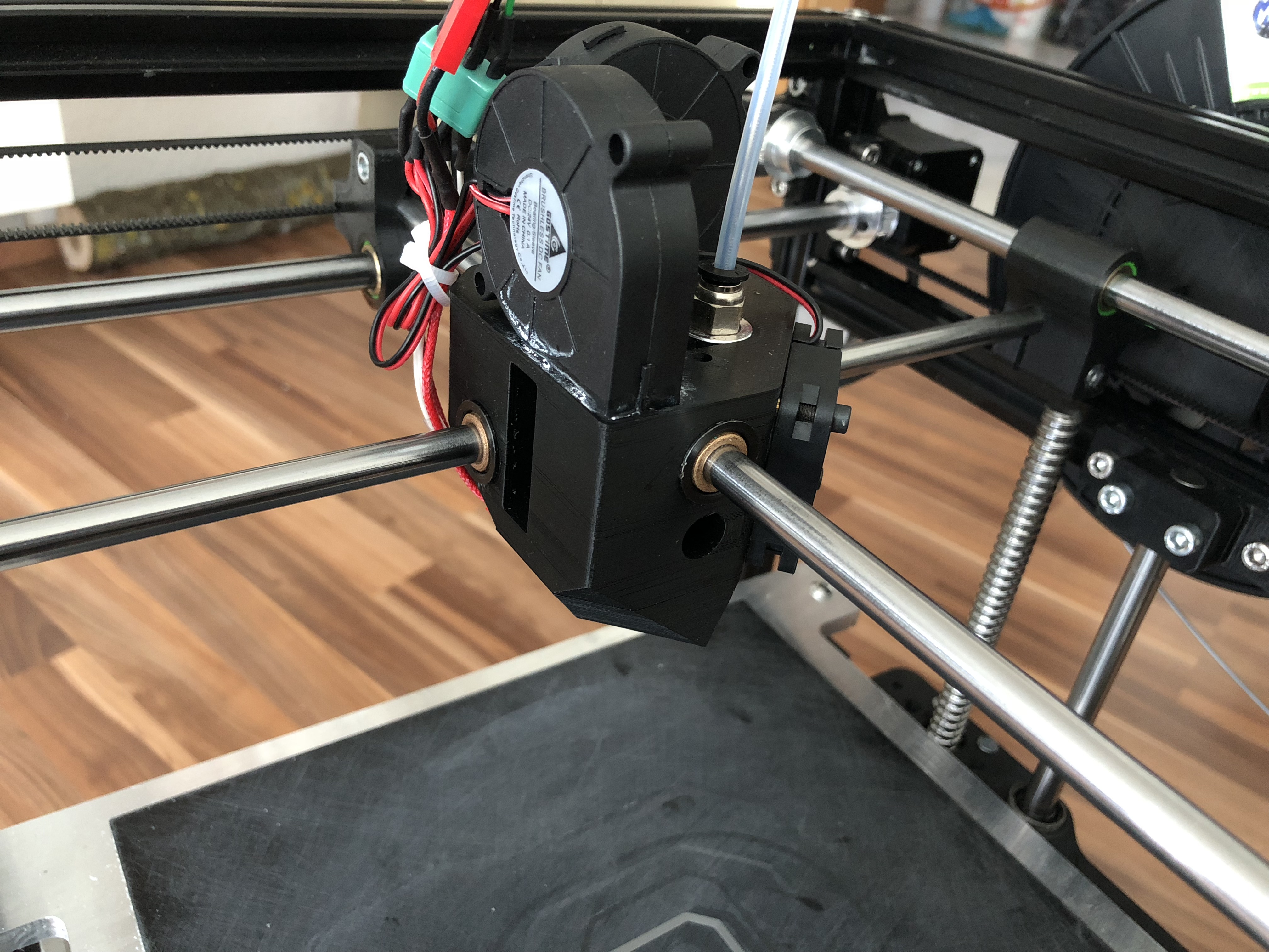

After i finished the Eustathios Spider V2 last year, i decided to build a smaller one from an old Cl260 (ultimaker clone) Frame: Eustathios Mini.
Workspace 180x180x220mm
Let the pictures speak for itself:
Sorry this got caught in the g+ spam filter.
Looking great. Thanks for sharing. How’s it running for you so far?
Btw I love the wood base. Adds a certain styling compared to the normal acrylic base.
So far, i’ very happy with the built. With this one, i tried a cheap 8bit setup with:
MKS Gen 1.4 > Marlin 1.1.8
TMC2008 from Watterott except the Extruder (E3D Titan) A4988. Ran in trouble with the TMC2208 on it. Travel Movement on x and y 350mm/s without a Problem
