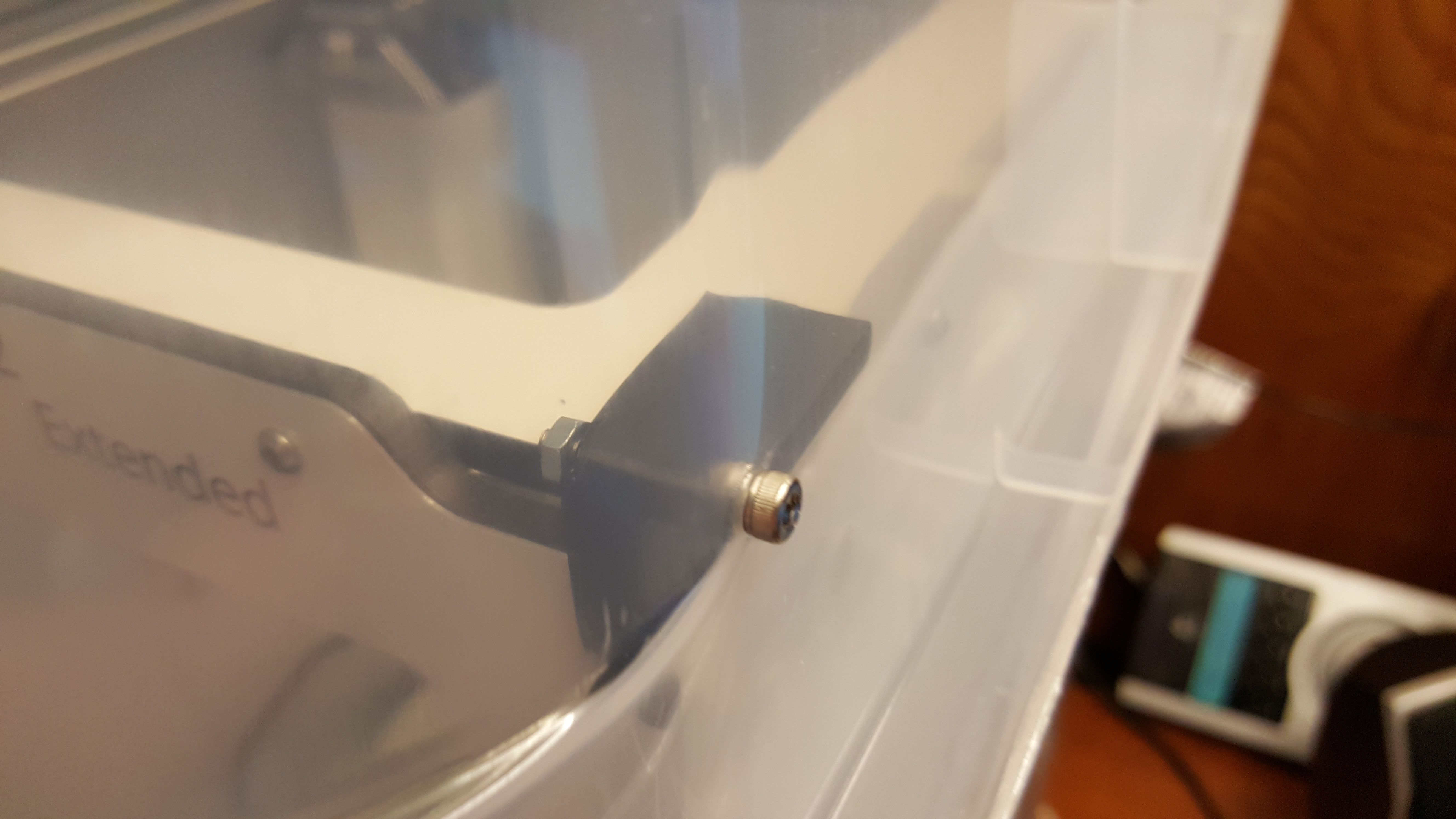

After learning about the emissions of PLA I built this "Chamber" for my Ultimaker.
After learning about the emissions of PLA I built this “Chamber” for my Ultimaker.
How do you think this will affect print quality? positively or negatively?
Used “FrostKing” insulation plastic intended for windows.
M3 Screws and Rubbermaid “roughneck” plastic container
Temperature at the bottom is about 20C at the top around 40-50C
If anyone wants it I will post the files for the little legs.

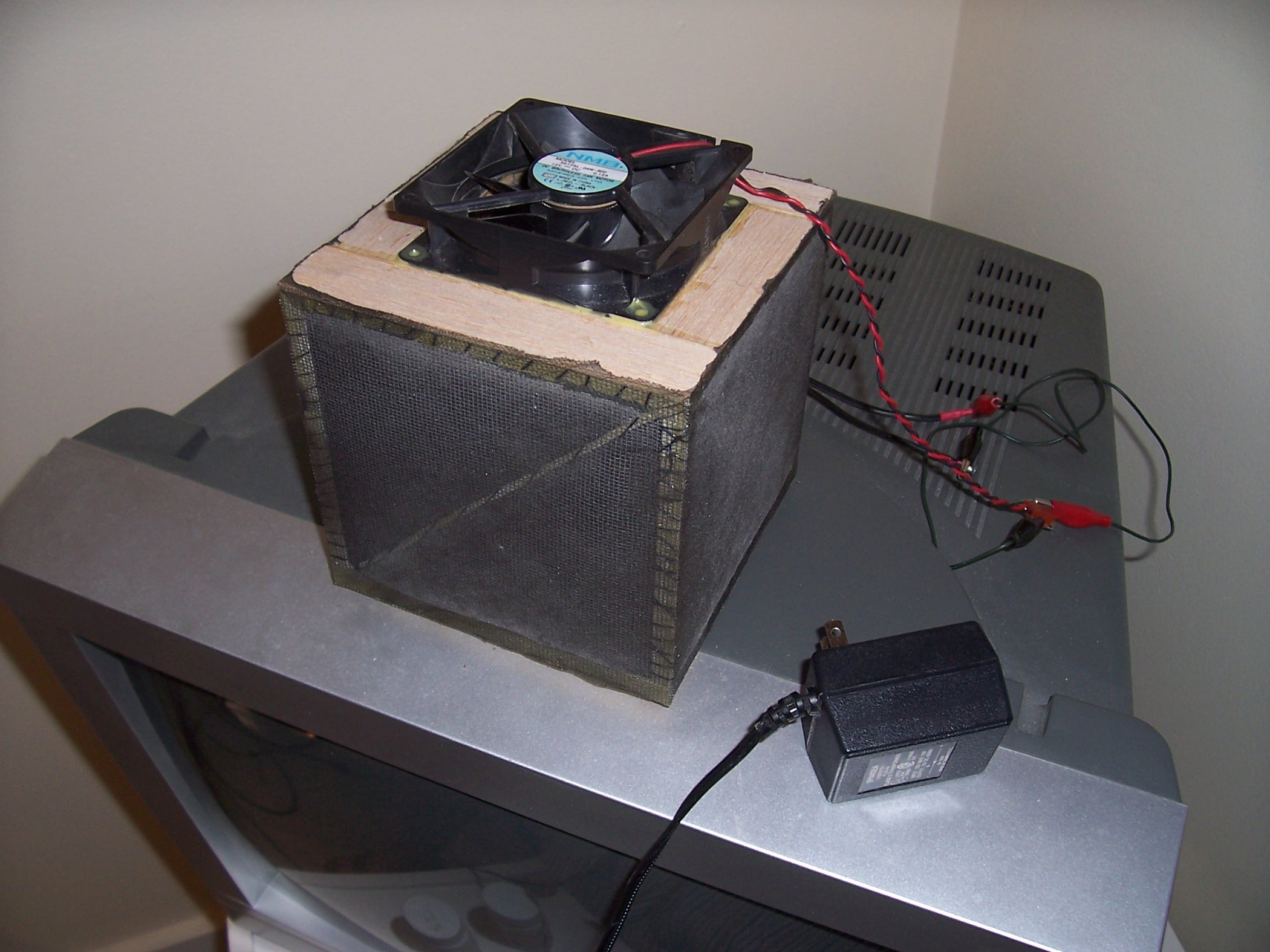

If activated carbon works then adapt one of these:
I also made a similar box for my 3D printer, I am planning to use a active carbon filter like for soldering fume extractors. I also hope the heat will be more homogenous inside
