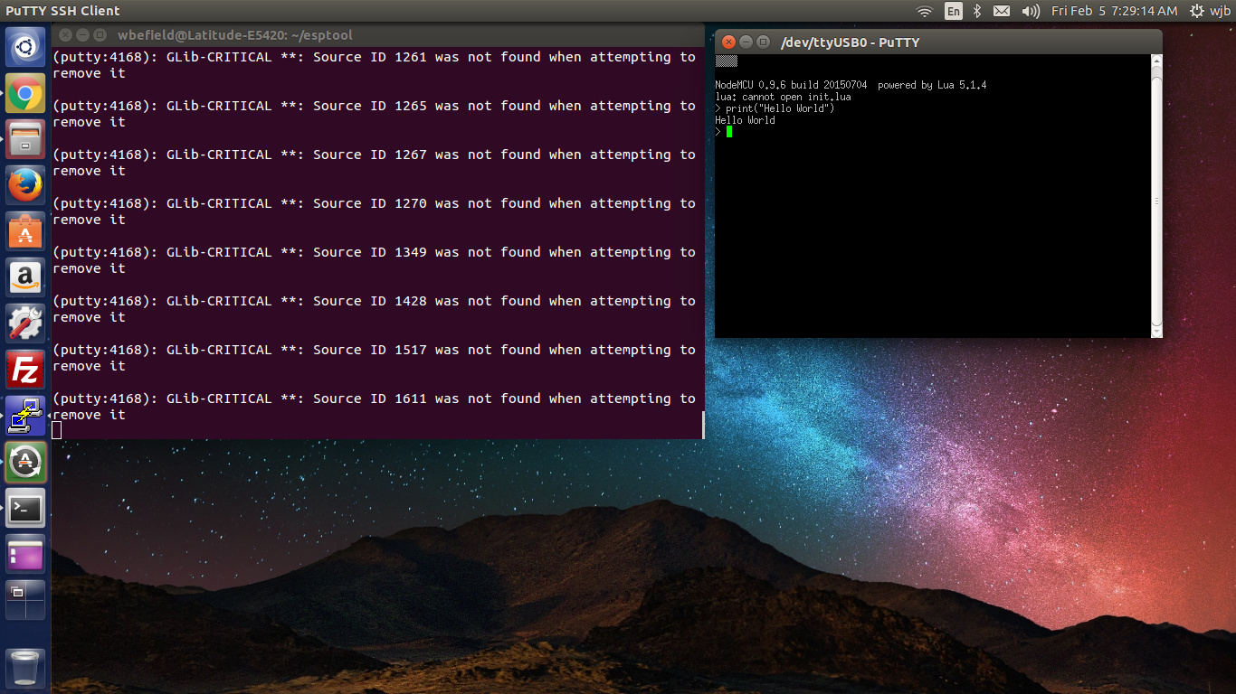

After lots of googling, I was finally able to flash my NodeMCU and run “Hello World” from Putty. yay!
Being new to NodeMCU and Ubuntu, I’m not always sure what I’m seeing in my terminal window. Looks like errors, but maybe not?
