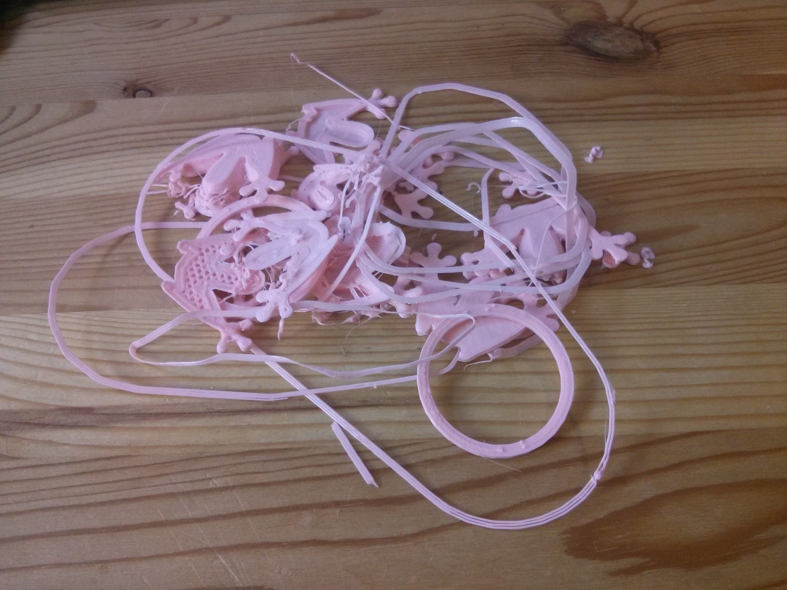

After many, many attempts I finally got one somewhat successful print of the treefrog. Printed with support in .3mm layer height.
The print had some small holes (I printed with 0% infill, and Slic3r does not create support inside the model) which I fixed with some excess PLA and tweezers heated over a zippo. Pics show the waste from failed prints, the fixed up frog, the frog with support and with support removed.
perhaps you should try cura and .2 layers. The .2 layers are better for the steep overhangs as they tend not to sag that much. Ive printed it without support and it worked good. Will post a pic if youre interested.

The latests version of slic3r just got the option of printing infill only where it internally supports overhangs - i haven’t tried it yet but it should take care of those nasty top holes.
