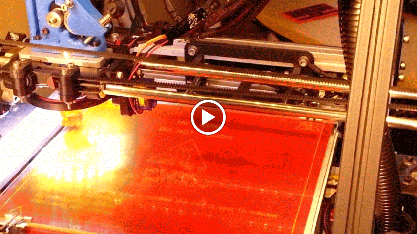

After only 2 and a half days of my girlfriend hating me for focusing all my attention to implementing auto bed leveling, I finally got it to work. No more calibrating my printer, ever, especially when I travel with it, just load the filament and print.

I should note I had the chance to experience something similar with the new Afinia H-series H480 printer. It comes with a cable that connects to the nozzle and the platform (separately) and you run a couple of diagnostics from the desktop software to both auto-level the platform and detect the nozzle height. Works quite well.
@Ricky_Cadden I would hope they have something to do it for you for almost $1700, it cost me $700 to build my mendelmax 1.5 and it prints just as good as a $31,000 stratasys dimension elite. This is why I love open source, you just need to figure it out and you can implement it very cheap. The cost of this upgrade was like $7 including the printed plastic, servo and switch. Now my printer is more predictable and reliable.
